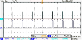

MSP432P401R: ADC Interrupt ISR compared to ADC Trigger
Part Number: MSP432P401R
Why does the ADC ISR only run every other ADC Trigger which is the Timer A0_1 source.
In the picture below
CH1 is the Timer A0_1 out which is the ADC trigger source and CH2 is an output bit togged on and off inside the ADC ISR.
Code is shown below.

  • With CONSEQ=3 and MSC=0, you get one conversion per trigger [Ref TRM (SLAU356I) Fig 22-10]. Since the interrupt only happens on the last (second) channel in the sequence you get one ADC interrupt every 2x conversions/triggers. You could:
    1) Enable the interrupt for both channels. This will give you low latency but (still) won't give you burst behavior.
    2) Use CONSEQ=1 and MSC=1. This will give you burst behavior -- 2x conversions per trigger -- but you will need to toggle (low then high) ENC between bursts (in the ISR, probably). [Ref TRM Fig 22-8]
    [Edit: I forgot option
    3) Decide that the current behavior is fine, and don't change anything. (Maybe double the trigger frequency.) Sometimes you don't care about bursting, since the channels are unrelated, and the ENC thing is a particular headache if you want to do DMA.]

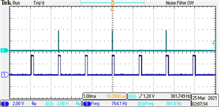

  • Thanks I tried using your 2) suggestion
    The updated code is

    Now the ADC ISR is happening on every Timer trigger.
    See scope shot below
