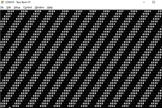

We are using SCI_TX and SCI_RX pin on Launch pad to send some basic data out to PC. ( Pin J11 - 32 GROUND, 33 - SCI RX , 34 - SCI TX )
TX pin on board is connected to RX pin on DB9 connector.
Data is decoded correctly on Logic scope
When We try to see the data on Tera Term ( Serial com port ) its not decoded correctly. Baud rate is correct and all other setting for serial port looks correct
    TMS570LC12x has two SCI modules: SCI, SCI2/LIN.
    On Launchpad, the SCI2/LIN signals are routed to TM4C129 MCU which converts SCI to USB. You can use SCI2/LIN to communicate with PC through USB port.
    The electrical and protocol characteristics of the TMS570 SCI peripheral are different from RS232. In RS232 communication, high level is typically +12 V and low level is typically -12 V, while the TMS570 SCI peripheral works with 0~3.3V. The RS232 transceiver should be used to transform the TMS570 SCI into RS232-compatible levels and vice versa.
