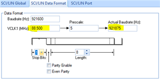

I am using the TMS570LS0714 in the PZ package. Currently I am trying to setup an SCI implementation using PIN 94 (LIN RX).
PIN 94 is connected with the RX singal of my external sensor.
My problem is that the sciNotification(sciBASE_t *sci, uint32 flags) function is not triggered by the RX interrupt (which is my intension)
Could you please have a look on my CCS code and Hal Gen settings?
Do you have an idea why sciNotification is not triggered?

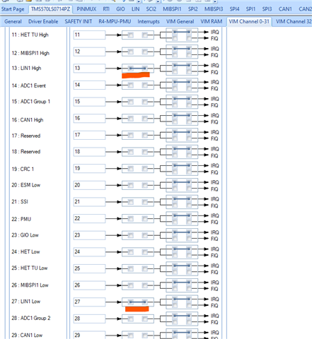

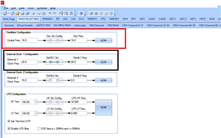

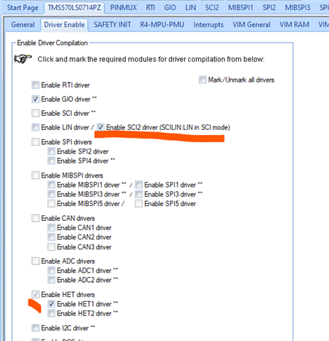

The settings in HAL GEN -> SCI2 -> SCI/LIN Global: was tested with RX int connected with High Level (as shown above) and tested with RX int NOT connected with High Level) both without success.
Also the settings in HAL GEN -> COM Ch. 0-31 was tested LIN1 High + LIN1 Low connected to IRQ and was tested with only LIN1 High conected to IRQ, both combinations without success.

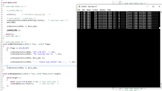

  • There is no problem for receiving 1 byte or more bytes:
    void main(void)
    /* USER CODE BEGIN (3) */
    //_enable_IRQ ();
    sciInit(); /* initialize sci/sci-lin */
    /* even parity , 1 stop bits */
    sciDisplayText(sciREG1,&TEXT1[0],TSIZE1); /* send text code 1 */
    wait(200);
    sciReceive(sciREG1, 1, &sci_cmd);
    _enable_IRQ ();
    while(1);
    /* USER CODE END */
    /* USER CODE BEGIN (4) */
    void sciNotification(sciBASE_t *sci, uint32 flags)
    if (flags == SCI_RX_INT)
    sciDisplayText(sciREG1, "GET a RX INT! ", 16);
    sciDisplayText(sciREG1, "The received char is: ", 23);
    sciDisplayText(sciREG1, &sci_cmd, 1);
    sciDisplayText(sciREG1, " ---- Please type another char...... ", 38);
    void sciDisplayText(sciBASE_t *sci, uint8 *text,uint32 length)
    while(length--)
    while ((sci->FLR & 0x4) == 4); /* wait until busy */
    sciSendByte(sci,*text++); /* send out text */

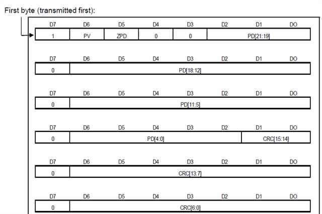

    The data frame I want to receive via the SCI2 RX pin is the following:
    Each frame is defined as 6bytes

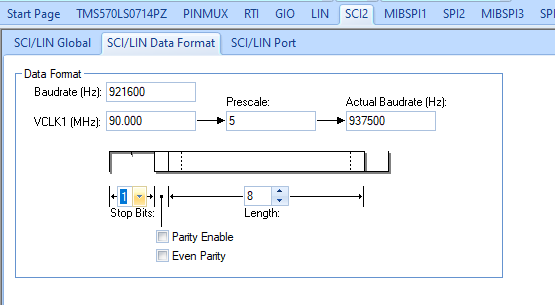

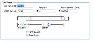

    My current HalGen setting is (I tried also 2 stop bits):
    I am not sure if I need to define a start bit in HalGen as shown in the first graphic above.
    And if yes, I dont know where I could add a start bit in the settings..
    I am currently struggeling to receive the 6 byte data frame via the sciReceive(scilinREG, 6, &sci_cmd) correctly. I am currently using the following code:

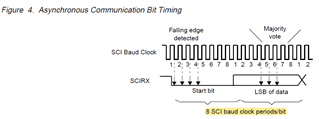

    There is only one start bit at the beginning of the frame.  It is not configurable. The number of stop bit is configurable (1 bit or 2 bits).
    The code in SCI notification looks fine to me. I used this way to read the received chars, and didn't see any issue.
    The data you get is ASCII code. If you type 1a in the UART terminal, you will get 0x31 and 0x61.

  • Thank you for the response! Could you please have a look again on the above data protocol. The sensor I use sends within one frame 6 bytes. Each byte is send with one start and one stop bit. After the last byte of the frame is send (byte number 6) an idle high state is activated until the frame is initialised again (after 10kHz). My Baud rate is 921600 using an PLL generated internal clock of 90MHz.
    Do I need to handle the idle state in a special way, since it is only send after the last byte of the frame (byte number 6) and not after each byte?

    To be more precise: baudrate is 921600 bit/sec, 8 bit data words, 1 stop bit, no parity, frame transmitted at 10KHz. One frame has 6 bytes:
    This means:
    - The time to send one byte is      (1/921600)*(8data+1 stop+1 start) = 10.85usec
    - The time to send all six bytes is (1/921600)*(8data+1 stop+1 start)*6 = 65.1usec
    - The idle state (waiting time at high level until next frame) is (1/10kHz) - 65.1usec = 35usec
    Does it have sonmething to do with the idle state which is only send after the byte number 6?
    Is the Sensor BaudRate of 921600 bit/sec too high?

    Could you please have a look on the baud rate settings (HalCodGen) as shown above. I use 921600 as the SCI Baudrate because it is the sensor baudrate.
  • The 1.7% baud-rate difference should be fine.
    You can adjust the baudrate by changing the VCLK. If PLL=177MHz, you can get 921875Hz of baudrate.
  • It is noted in HalCoGen that your suggested PLL of 177MHz is too high, please see below.
    I therefore changed the settings to (0.07%):
    But no improvement.
    Can it be that the SCI Baud Clock must be 8 times higher than the baud rate of the sensor? When I look on page 10 in "TMS470R1x Serial Communication
    Interface (SCI) Reference Guide" I can see that each bit is sampled by 8 SCI baud clock periods:
  • Dear Wang

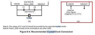

    I have a possible hint to find the problem. I measured the ECLK output pin with an external scope.
    I connected the oscillator frequency of 16Mhz with a divider of 8 to the ECLK pin. From this, I expect to measure a frequency of 2MHz. However, I measured a frequency of 2.5MHz. Could it be that the internal clock/oscillator is not working healthy?
    I also generated an RTI interrupt and toggled an output pin. The setting was 10 Hz and 100 Hz. I measured at the toggle pin 6.25Hz and 62.5Hz. It seems like there is a deterministic error of one internal clock.
    I use as an external clock signal the following device (20MHz): DSC1003DL5-020.0000
    connected as:
    Do I need to change the Crystal Freq. from 16MHz to 20Mhz (red box)?
    What happens when I dont connect the external 1 clock (black box)?
  • For TMS570 devices, each SCI data bit has a duration of 16 vclk periods. This means that the VCLK has to be at least 16 times of SCI baudrate.
  • Do I need to change the Crystal Freq. from 16MHz to 20Mhz (red box)?
    Yes, you need to change the crystal frequency accordingly.
    The external clock 1 (black box) means the clock is from the external clock input #1 (pin 10 on PZ package).
  • Please change the crystal frequency to 20.0 in the read box:
  • The problem was the wrong setting of the crystal Freq. I receive the expected data stream after I changed the crystal frequency from the standard configuration of 16MHz to 20MHz of the external clock. Thank you for the support!
