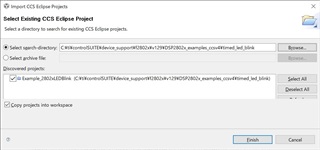

  • Hi Cody,
    How do you load the sample code?
    I got an error when I added the project using the following steps.
    “Project → Import Existing CCS/CCE EclipseProject”:

  • Wada-San,
    CCS is indicating that it cannot find that project file. Please navigate to that location on your PC and verify it exists. It is possible that the path on your PC is different than mine, either due to the install root or having a different version of controlSUITE.
    Cody
  • Hi Cody,
    I have confirmed that the file exists on my PC.
    Does the specified folder contents match in the next image?
    Does the selected project match with "INSTALLROOT_F2802X_V230"?
    Please let me know if you find the missing file.
    There is also a "timed_led_blink" file in the following location:
    C:\ti\controlSUITE\device_support\f2802x\v230\f2802x_examples_structs\timed_led_blink
    Can I try it with this file?
    Thanks.

  • Hi Cody,
    The project loading error seems to be affected by "macros.ini".
    C:\ti\controlSUITE\device_support\f2802x\v230\f2802x_examples_drivers\timed_led_blink
    The following project succeeded in loading.
    C:\ti\controlSUITE\device_support\f2802x\v129\DSP2802x_examples_ccsv4\timed_led_blink
    When I built the project, I got the following warning:
    warning: entry-point symbol other than "_c_int00" specified: "code_start"
    Setting "Symbol Management" to blank removes the warning.
    The project build and debug were successful without any problems.
    Thanks.
