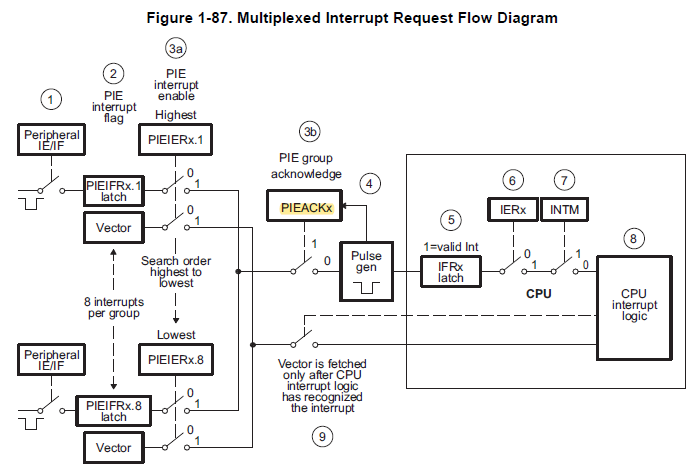

Since both interrupts are coming form PIE group 1 and fed in to CPU INT1, it is not clear to me how the priority logic works. But based on Tms320F28069-FanmilyRef-spruh18h and C28X Interrupt Nesting app-note it seems, to allow DP_ISR to interrupt MotorInvISR  you need to
1. clear PIEACK.INT1 to unblock interrupts from PIE group 1 and
2.  set  IER.INT1  to reenable cpu  INT1 which is currently disabled as MotorInvISR is in progress.

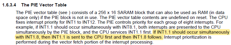

    When multiple interrupts from a single group are simultaneously active, the interrupt with the lowest enumerated value has priority:
    In the case of the example, DPL_ISR (ADC_INT1 / INT1.1) is meant to interrupt the execution of MotorInvISR (ADC_INT2 / INT1.2). When EINT enables interrupts in MotorInvISR, the hardware PIE group arbitration logic naturally prioritizes the execution of DPL_ISR when ADC_INT1 is triggered.

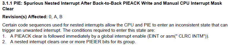

    One problem that I see however, is that the PIEACK bit for Group 1 does not seem to be cleared until the end of MotorInvISR, so ADC_INT1 is most likely being stalled until the end of MotorInvISR:
    This then leads to potentially more trouble as the sequence is now susceptible to the undesired interrupt behavior that is documented in the Errata:
    I think it would be a good idea to redo the nesting implementation according to the article.
