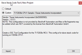

From my understanding we start with SSC by creating a new project and importing the XML file f2838x_ssc_config that is already containing the PDO. How can I generate the same kind of file? Do I need to manually edit this XML to fit my application?
Also what is the difference between: TI F2838x CPU1 Sample (include Sample Application) and TI F2838x CPU1 Sample ? The "Sample Application" is generated to be imported in ccs?

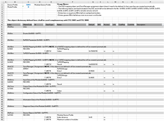

    I created a new application using TI F2838x CPU1 Sample without Sample Application:
    and fill the Excel as below:
    It's basically just one input and one output. I generated the Slave file and import it in CCS. I would like to implement APPL_InputMapping() and APPL_OutputMapping() as below:

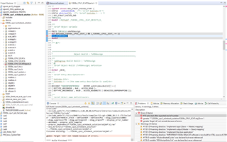

    But Result0x6000 and Value0x7000 are not defined.
    If I check F2838x_CPU1_EtherCAT_Slave_1in1out1Objects.h I don't see my variables declaration:

    Normally it should be directly generated by SSC right?
    As  ask 3 years ago, it would be nice if you had a manual on how to create an application for C2000.
    The tool should generate the header file. In this case it is not clear why it is not happening. Are you seeing any errors while importing the excel? One question I have is on why the input and output data is of type RECORD if you have only one variable. Shouldn't these be a VARIABLE type?
  • I used RECORD so I can add more variables in the future.
    I tried several times, it looks like when I am creating a new application, SSC open the Excel and directly parse the file and create the PDO of the empty Excel. It does not wait till I filled the Excel sheet... so that is why none of my variables were declared in the Object.h .
    Now that I fixed that, I can see my variables declared in the Object.h but if I try to compile and get several errors Upside down:
    Good to know that the SSC tool issue is fixed and you are seeing the generated objects.
