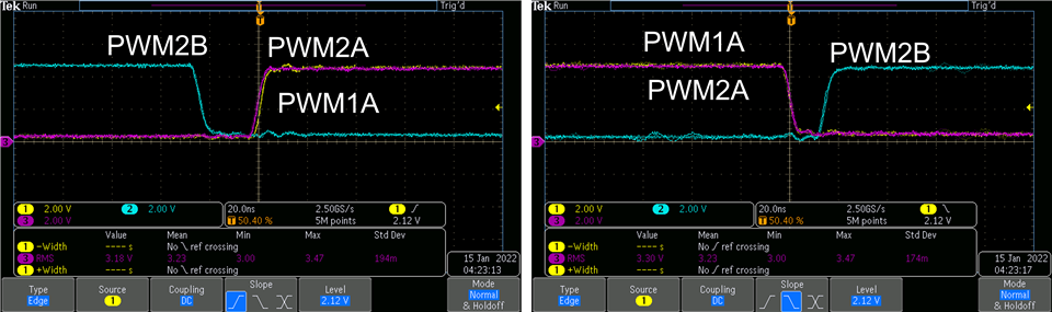

I would like to add HRPWM TBPHSHR capability to my dual active bridge. I am currently only looking at one side of the bridge, so I have two PWM channels with A and B outputs. The A/B outputs on each channel (EPWM1 and EPWM2) are run at 200kHz, ~50% duty (minus deadtime) and complementary to one each other. EPWM1 is the master leg and TBPHS is used to set a phase shift between EPWM1 and EPWM2. The converter works as expected using only TBPHS (no TBPHSHR), but I would like more resolution.
From my understanding if I use the deadtime Active HI complementary setting, I should still get a complementary signal even if HRPWM TBPHSHR is added. I need the deadtime, so I don't think I can use the SELOUTB setting to just output inverted "A" as B. My PWM code is setup below.

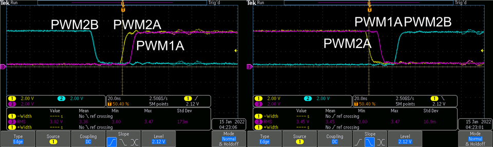

What I am noticing is when I added TBPHSHR, I lose waveform symmetry where HR phase is added to the negative cycle, but not the positive cycle. You can see this in the width measurement and its about 10 ns difference when I add the full TBPHSHR range. Autoconvert is on and the timing is correct but something in my setup is causing my PWM2 A/B to no longer be complementary when adding TBPHSHR. Any help is appreciated

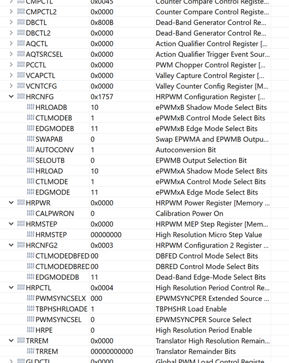

#if ENHRPWM == 1
    EPwm1Regs.HRCNFG.all = 0x0;
    EPwm1Regs.HRCNFG.bit.EDGMODE  = HR_BEP;  // MEP control on falling edge
    EPwm1Regs.HRCNFG.bit.EDGMODEB = HR_BEP; // MEP control on falling edge
    EPwm1Regs.HRCNFG.bit.CTLMODE  = HR_PHS;
    EPwm1Regs.HRCNFG.bit.CTLMODEB = HR_PHS;
    EPwm1Regs.HRCNFG.bit.HRLOAD  = HR_CTR_ZERO_PRD;
    EPwm1Regs.HRCNFG.bit.AUTOCONV = 1;      // Enable auto-conversion                                             // logic
    EPwm1Regs.HRPCTL.bit.TBPHSHRLOADE = 1;
#endif

#if ENHRPWM == 1
    EPwm2Regs.HRCNFG.all = 0x0;
    EPwm2Regs.HRCNFG.bit.EDGMODE  = HR_BEP;  // MEP control on falling edge
    //EPwm2Regs.HRCNFG.bit.EDGMODEB = HR_BEP;  // MEP control on falling edge
    EPwm2Regs.HRCNFG.bit.CTLMODE  = HR_PHS;
    //EPwm2Regs.HRCNFG.bit.CTLMODEB = HR_PHS;
    EPwm2Regs.HRCNFG.bit.HRLOAD  = HR_CTR_ZERO_PRD;
    EPwm2Regs.HRCNFG.bit.AUTOCONV = 1;      // Enable auto-conversion
    EPwm2Regs.HRPCTL.bit.TBPHSHRLOADE = 1;
#endif

Zoomed Out figure showing symmetric waveforms when TBPHSHR = 0
Zoomed in when TBPHSHR = 0
Zoomed in when TBPHSHR is close to max
