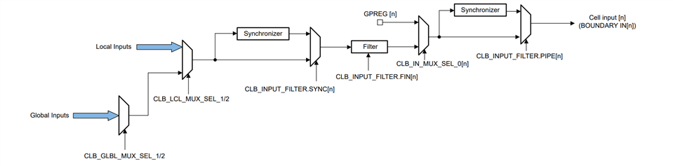

    1. CLB Input XBAR selections are available at the local mux:
    You then have to select the local mux input you want to route it to a BOUNDARY INx. Then route the BOUNDARY inx (now you are in the tile) to OUTLUT in the actual tile,
    2. External inputs to the TILE are the BOUNDARY INx signals. In the CLB GUI tool they are available as a drop down.
    3. These 8 BOUNDARY INx signals are comming from various muxes.
    4. Again, the resigters you are trying to configure/code for configuring them would all be generated for you by the GUI tool. But if you want to configure them manually you have to configure:

    ClbInputXbarRegs.INPUT1SELECT= 11; // GPIO11 as CLB INPUT X-BAR INPUT, page 1265, Table 12-5
    ClbInputXbarRegs.INPUT2SELECT= 27; // GPIO27 as CLB INPUT X-BAR INPUT
    ClbInputXbarRegs.INPUT3SELECT= 42; // GPIO42 as CLB INPUT X-BAR INPUT
    // INPUT1 from CLB INPUT X-BAR is configured as Local signal and passed as BOUNDARY IN_0 (inside CLB tile already), page 1256, Fig. 12-4, Table 12-2
    Clb1LogicCtrlRegs.CLB_LCL_MUX_SEL_1.bit.LCL_MUX_SEL_IN_0=48;
    Clb1LogicCtrlRegs.CLB_LCL_MUX_SEL_1.bit.LCL_MUX_SEL_IN_1=49;
    Clb1LogicCtrlRegs.CLB_LCL_MUX_SEL_1.bit.LCL_MUX_SEL_IN_3=50;
    // External Input 0 (BOUNDARY IN_0) as IN_0 to OUTPUT LUT block of CLB through STATIC SWITCH BLOCK, page 1271, Table 12-4, page 1279, Fig. 12-14
    Clb1LogicCfgRegs.CLB_OUTPUT_LUT_7.bit.IN0=24;
    Clb1LogicCfgRegs.CLB_OUTPUT_LUT_7.bit.IN1=25;
    Clb1LogicCfgRegs.CLB_OUTPUT_LUT_7.bit.IN2=26;
    Clb1LogicCfgRegs.CLB_OUTPUT_LUT_7.bit.FN=0x96; // XOR function LUT
    Clb1LogicCtrlRegs.CLB_OUT_EN=0xFFFF;
    Clb1LogicCfgRegs.CLB_MISC_ACCESS_CTRL.bit.BLKEN=1;// allow CLB1_OUTx to CLB OUTPUT X-BAR, page 1267, Fig. 12-7, Reg: page 1340, Table: 12-57

  • 1. The second value in red is the old value. The tool shows you a live change log as you change the settings in the tool. The green one is the important one and it matches.
    Q3. I think the only other thing that could be causing the probelm is the mux select signals. I think the boundary in configuration for all of the muxes may be incorrect. Before we look into that, if you bring out the signal for OUTLUT7 to a GPIO using OUTPUTXBAR, can you see the XORed signal?

  • Okay so here is what I have:
    1. CLB Input XBAR setting:
    2. CLB Mux selection (local mux, select the CLB INPUT XBAR entries):
    3. The CLB tile configuration
    Then finally, follow by overriding the ECAP signals.
    This would be all that is needed.

  • The items that you want to check is to see if the CLB_configLocalInputMux and CLB_configGlobalInputMux modify the registers as you did. There are sometimes some additional bits that get set to ensure the configuration is correct, for example:
    You have to have line 71 for line 70 to propagate through the muxes.
