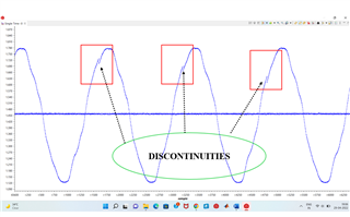

Hi Team,
I'm posting on behalf of the customer.
I am using a TMDSPREX28335 board. I am trying to dump an external sinusoidal signal (grid voltage which is 50 Hz) into the controller using its ADC port. The signal is well conditioned and is between the safety limits of 0 and 3 Volts.
Initially, I had tied the ADC to CPU Timer0 Interrupt (happening every 25 micro seconds or 40 kHz) and observed the signal in the GRAPH window.
The code for ADC triggered by CPU TIMER0 Interrupt is as follows:

The graph corresponding to the above code is this:
As you can see there is a discontinuity in the (converted) viewed signal.
I then reattempted by giving command to the ADC from the ePWM1 Interrupt (under the same conditions i.e., every 25 micro seconds or 40 kHz). The code for ADCSoC from ePWM1 Interrupt is as follows:

And the corresponding output in the graph window is as follows:
As you can see in both the cases (be it ADC connected to TIMER0 interrupt or ADC connected to ePWM1 interrupt) I am getting discontinuous data even though I am collecting 800 points (50 Hz = 20 milli seconds, 40 kHz = 25 us; 20m/25u = 800 points) and plotting all of them.
Another interesting thing is that even though the ADCTRL2 should either show 0x4800 or 0x2800 (depending on RST = 1 or SOC = 1) in case of TIMER0 Interrupt or 0x4900 or 0x0999 (depending on RST = 1 or 0) in case of SOC by ePWM1. However, ACTRL2 is maintaining a permanent value of 0x0800 for TIMER0 and 0x0900 for ePWM1.

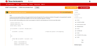

  • Hello Mr. Pate,
    I shall try to post the information that you have requested from me by tomorrow and run a couple of extra tests as well to figure things out. However, I think I have seen such a post on the E2E forum where the user was going through a similar kind of trouble.
    Here is the link to that thread:
    https://e2e.ti.com/support/microcontrollers/c2000-microcontrollers-group/c2000/f/c2000-microcontrollers-forum/867065/ccs-tms320f28335-sine-signal-reading-problem
    Manish Bhardwaj dealt with this thread. Unfortunately, there isn't anything on this thread which can be used to solve my issue.
    I'll try to scratch my head a bit and figure things out. And apologies for prolonging this post.

  • Hi Pate and Ankit,
    Here is the image of the graph that Ankit mentioned.
    I hope this helps.
    Marvin
  • Ankit,
    Can you attach/copy the contents of the sample array, perhaps the last 20 counts of the 1st array and the first 20 counts of the 2nd array, etc.
    Looking at the data plots, even though there is a discontinuity it appears that that this data may be an exact copy of the previous samples.  i.e. if I push back the discontinuity in time it might overlay exactly with the previous data.  This would give some indication that we are re-using old data somehow in the code.
    Matthew

    c) Did you get a chance to go through the similar issue that was handled by Manish Bhardwaj? This is the link to that thread:
    d) This glitch only appears while plotting an external AC signal fed via ADC to the controller. It does not appear when an internally generated signal is plotted or if the external signal is DC.
    e) You mentioned that break out of the code. How to do it? Does it mean pause the code? Or should I just disable the continuous refresh on the watch window and copy the data after hitting the refresh button each time?
    f) I even tried to change the sampling rate of the graph, however, the glitch still exists.
    g) Maybe this is only a graph related glitch, however, will this affect my control algorithm and the controller gains?

  • Hi Matthew,
    Here is the graph that is showing the discontinuities as mentioned by Ankit.
    I hope this helps.
    Marvin

    I am unable to conclude anything from the dataset, however, I would request Marvin to either upload that excel file here or email it to you directly. There's one more E2E thread where there's a sentence written by tlee  and it is as follows:
    "The continuous refresh of the graph is not guaranteed to operate synchronously with the circular buffer updates so you can see occasional "glitches" in the plot."
    The link to this E2E thread is as follows:
    https://e2e.ti.com/support/microcontrollers/c2000-microcontrollers-group/c2000/f/c2000-microcontrollers-forum/805741/ccs-tms320f28335-error-adc-sampling
    I will take a screenshot of that entire response and share that as well with Marvin so that he can post it here.

  • Hi Matthew,
    Here is the screen capture of the thread as Ankit mentioned as well as the excel file. Please refer to the attachments below:
    dataset.xlsx
    I hope this helps.

  • Ankit,
    Thanks for taking the data, with the data we see that there is not a discontinuity in the data, i.e. transitioning from 799 of 1st to 1 of 2nd data set still shows decreasing data and not a spike back up to a previous value.
    So, this is being caused by the graph function in CCS and you have found a previous post that hints that this is an issue as well.
    While the graph is not desirable, the foundational data is good, i.e. any mathematical operation that would be done on the data will be good as well.
    My point is that we can ignore the graph discontinuity, knowing that the data collected by the C2000 is good/correct.  Is there some other aspect of the graph that will give rise to issues for you?
    Matthew

    Assume that the vector in which the grid voltage is being stored has a length of 800 samples. Then in such a case, the user should only plot 800 samples at a time. If the user plots more than the vector (assumed 800 in this case) then the discontinuity would appear at the end of every vector length (or after every 800 samples in this scenario). As the input signal is continuous, there is no guarantee that the next 800 samples would be exactly the same as the previous 800 samples and the graph needs its own time to fetch fresh data at every single iteration resulting in an additional delay which further contributes to this glitch. So, in the graph properties for the current vector length of 800 samples both of these parameters (acquisition buffer size, and, display data size) should be kept as 800 to view the signal glitch free. The user should store as many cycles as possible in the same vector for better visibility.
    Furthermore, to view multiple cycles of the input signal in the same vector lesser number of samples should be stored. Assume the input signal frequency is 50 Hz and the rate at which the data is being read from the ADC is 40 kHz. This means 800 values are being read for one cycle of the input signal and gives us a vector length of 800. If the user stores every alternate sample, then, in the given array of 800 size, 2 cycles of the input can be viewed simultaneously. If the user stores every 4th sample, then, 4 cycles can be viewed simultaneously, and so on.
    You may close this thread now as the issue no longer exists. If you agree with my explanation then you may vote for my reply as the suggested answer.
