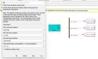

I use matlab 2022a. test on F28379D Launchpad
I use CLA task trigger source for epwm1 for toggle led, it's ok
but when i use C28x_Hardware_Interrupt block trigger epwm6 interrupt,  cla_subsystem not operation, led not toggle.
i remove the interrupt vector of epwm6 cla_subsystem operation, led toggle.
when i use matlab 2021a i can use CLA and epwm interrupt. How to fix this issue
