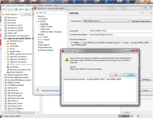

Difficulty to open a configuration file imported with an C200ware v4.01.00.00 Example project below, Error message "must have lower version SysConfig installed", that made no difference. Trying to open the same file in standalone SysConfig latest version download complains, "missing argument board or device must be specified."
Comment out the missing include board.h did not help to stop the CCS error messages or Desktop standalone SysConfig. Contrary to the function of SysConfig files are to help explain project details is puzzling that it seems to believe the project should have some other includes that were not part of the CCS import location. What can be done to remedy SysConfig error messages?

    I believe this is likely caused by the older CCS version, but there is a way to get around the "missing argument board or device must be specified." issue:
    1. Open the project properties window (right click project and choose properties)
    2. Go to Build->Sysconfig->Basic Options
    3. Make sure there is only one entry in the list, as shown below. Delete every other entry:
    4. Go to Build->Sysconfig, then click "Edit Flags"
    5. Ensure the flags looks like this (but with the device items updated for your device if below doesn't match your device):
    -s "${C2000WARE_ROOT}/.metadata/sdk.json" -d "F28004x" -o "syscfg" --package "F28004x_100PZ" --part "F28004x_100PZ"
    6. Make sure the same settings above are in the ".syscfg" file you have highlighted, in the @cliArgs section. You will need to right-click the .syscfg file and choose "Open With->Generic Text Editor". The below will likely work for your device (this is the whole header for the ".syscfg":
     * These arguments were used when this file was generated. They will be automatically applied on subsequent loads
     * via the GUI or CLI. Run CLI with '--help' for additional information on how to override these arguments.
     * @cliArgs --device "F28004x" --package "F28004x_100PZ" --part "F28004x_100PZ" --context "system" --product "C2000WARE@4.02.00.00"
     * @versions {"tool":"1.0.0+dev"}
    Step #5 above can be a bit tricky, because sometimes the flags don't take properly. You have to make sure that once you click "Apply and Close" that you go back and check that none of the flags got duplicated. Sometimes, if a quote is missing, or a dash, it can duplicate the flags.
    Let me know if this helps.
    Vince

  • Hi Vince,
    Yes CCS 9.3 has the config editor but the alias (--context "system") is unrecognized trying to edit via CCS (Error unable to pars CLI arguments). First it complains --context unrecognized, removed it, then editor complains "system" unrecognized and removed that too. Now the editor complains unrecognized (*) but there is no (*) anywhere I can see.
    I have both versions installed and it does start a new project and open existing ones I created some time ago in the cloud.
  • GI,
    The release notes for C2000Ware 4.01 state that CCSv11 or later is required.  So you could use CCSv11.0.0, 11.1.0 or 11.2.0.  I have no idea if it was just tested with v11 or if the projects actually use features that are only present in CCSv11 or later.  So I would certainly hesitate to use v9.3.0.
    These daysSysConfig is generally pretty compatible across CCS versions but in CCSv9.3 CCS did not support switching SysConfig versions. So even though it is detecting the newer SysConfig installs on your machine it will actually be using the one that shipped with CCSv9.3, which I think is 1.3.  The 1.3 version is not new enough for C2000.
    You really should be using a newer CCS.  If you really really really have to use 9.3 you could try replacing the SysConfig in the ccs/utils folder with one of the newer ones that you have installed.  i.e rename the existing sysconfig folder to backup_sysconfig.  Then copy in the folder for one of the newer ones and then rename it to sysconfig (without the version on the end).
    However I will stress again that a newer CCS is required to be a supported environment.

  • Great but recall past downloading CCS9.3 the newer CCS11 had note Win10 requirement. I did not uninstall SysConfig v1.3 did the copy to folder v2.1, works ok for now. Thanks again!
