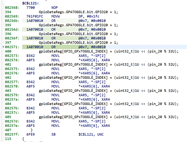

I have a question regarding the toggle speed of a GPIO pin.
The standard library function   e.g.  GPIO_togglePin(DEVICE_GPIO_PIN_LED1); has some extra lines of code and so I change the toggle code in the following way:
The first toggle method  I checked was with the C code:
 GpioDataRegs.GPATOGGLE.bit.GPIO20 = 1;
which gives the ASM code of:
1A070010    OR           @0x7, #0x0010
The second toggle method  I checked was with the C code:
    gpioDataReg[GPIO_GPxTOGGLE_INDEX] = (uint32_t)1U << (pin_20 % 32U);
which gives the ASM code of 2 lines:
082573: 8342 MOVL XAR5, *-SP[2]
082574: A8F5 MOVL *+XAR5[6], XAR4
Question:
the first toggle method (GpioDataRegs.GPATOGGLE.bit.GPIO20 ) takes  ~ 58,3 ns to toggle the GPIO pin, but the second method only takes 41,5 ns.
What is the reason for this behavior and how does this fit with the timing CYC of the instructions?
According the data sheet the Bitwise OR should take only 1 CYC. Looking at the disassembly code I expected that running the  assembly instruction:
 => total time: 58,3ns
is faster, than running 2 assembly instructions to toggle the pin
 => total time: 41,5 ns.

  • Hi Bernhard,
    After discussing with the ISA experts, they have provided the following information:
    While it is true that a stand-alone “OR” instruction is indeed a single-cycle instruction, the actual cycle count will also depend on pipeline protection cycles which could occur due to the instructions in the pipeline before the current instruction.
    In this specific case, the “OR @7, ..” instruction will issue a memory read to the GPIO register space and this could result in regular or block protection cycles.
    However, in the other case of two assembly instructions, the first instruction reads the local stack memory and the second instruction does only a write to the GPIO data reg and hence there will not be any block protection cycles. As explained above, the CPU and block protection pipeline stalls can introduce more cycles than just the basic instruction cycle count.
    The TOGGLE and similarly with SET, CLEAR registers in the GPIO Mux is a write only register (write 1 to toggle the pin), reading the register always returns a zero.
    Therefore if you want to manipulate any GPIO output (TOGGLE, SET high, CLEAR low), all you need to do is write a "1" to the respective bit of the registers.
    How the bits get manipulated now depends on how you write your C code.
    If you write the code as follows:
    The compiler generates a Read-Modify-Write Operation "OR" as follows:
                    OR           @0x7, #0x0010
    This operations reads the TOGGLE register (which returns a zero), then OR's the value with #0x0010 and then writes it back to the TOGGLE register, hence forcing the output that was written a "1" to toggle.
    The read operation is redundant. All you need to do is perform a write of a 16-bit value to the register. For example:
                  gpioDataReg[GPIO_GPxTOGGLE_INDEX] = 0x0010;
    This would generate the following assembly instruction:
                  MOV  @0x7, #0x0010
    Now you are only performing a write operation and no read operation is necessary. This is a lot faster as reads take 3 cycles and writes take 1 cycle (assuming no other operations on the registers cause a pipeline conflict).
