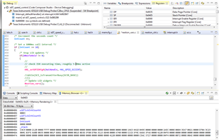

    Once you get the ITRAP/Illegal instruction ISR, could you look at the CPU register SP(Stack Pointer), then open up a memory browser to the address listed in the SP?  You'll want to look before that address, say 20 words or so, and if you screen capture this and post it I can see if I can resolve the address the ITRAP0 came from, which will help us narrow down the offending memory region.

  • Hi Matthew,
    Posted the debug memory results above. I noticed ITRAP0 was occurring at various places in the code after commenting suspect function calls in the command chain. If I commented out a call in a function suspected to cause ITRAP0, mcopy(x,x,x) would not copy those FB0 functions into RAMLSx. So it would seem like SCIB INT9.4 TX ISR was functional (No ITRAP0) up to the commented part then the SP, IP registers would stop instruction decode.
