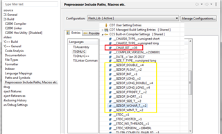

  • Seems the project preprocessor TI-Assembly Built-in symbol (red box) in part is causing char array cell length issues. Why would (char) be defined 16 bits amazes and seems to be partly the cause of CPU casting uint16_t from C lib (array.c) functions. So strlen() in this area of the debug code was producing odd lengths for 16-bit char array cells cast a uint16_t. This seems to break existing code when external HID sends 8-bit bytes to SCI FIFO and #defined char buffer. Oddly ARM compiler has (_stdint.h) where it includes uint8_t though it would not fix the C2000 compiler issues defined char=16 bits.
    Yet the debug code simulator caught this casting error behind closed curtains, not visible to the human eye.
    And the other part being #include <stdint.h> in ARM compiler project has Built-in compiler settings symbol __TMS470__ , missing in C2000 compiler. That missing symbol voids #include <stdint.h> for uint8_t. Several issues can be easily fixed by first updating stdint.h to include newer C2000 MCU classes. Secondly change char=8bits and add wchar=16bits.
  • What would be the odds of User added CDT macro (green box) to override compiler predefined macro, __CHAR_BIT__=16?
  • The odds were against 8bit wide (char) being added via User supplied CDT list. Removal of TI Assembly predefined symbols macro list made no difference as the compiler forcibly sets 16bit minimum word length. Have to wonder who at ISO came up with such a brain fart as it backfired thus wasted many hours debugging what without fully reading the entire compiler guide, I had no idea of the C2000 C library being an ISO pet project.
