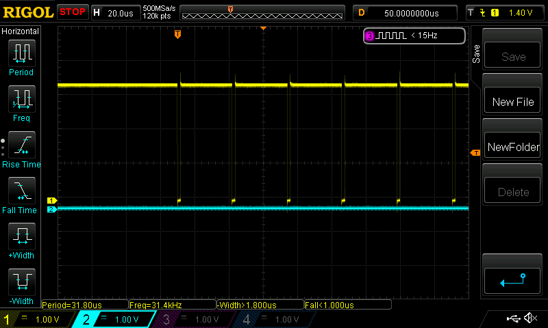

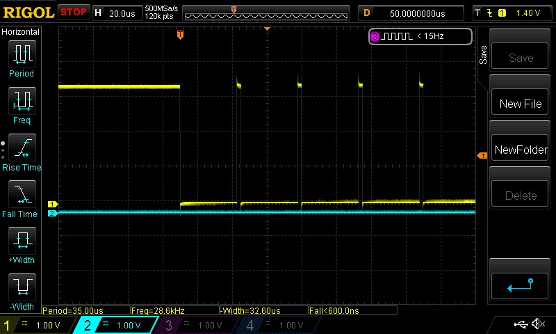

  • I did two measurements and I have attached the oscilloscope images of them. The pin will be set in a timer 1 interrupt and cleared when the ADC end of conversion interrupt is ready. In a first picture the timer is 35us and in a second one 20us. I really can't understand why in the second image the interrupt seems to take so much longer.
    JHi
  • I forgot to mention that if I toggle the pin from the timer interrupt, the timing will match to what I set it to be. Mean with 20us the pulses comes every 20us. There seems to be something fishy when using timer to trigger ADC conversion.
