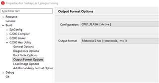

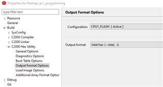

The issue is related to the output generated.
If I change the output format in ""BUILD / C2000 Hex Utility / Output Format Option" I get the following result:
  • BIN
    FW correctly generated, attached in the zip "flashapi_ex1_programming.bin"
    Here below the settings:
  • HEX
    FW NOT correctly generated, attached in the zip "flashapi_ex1_programming.hex"
  • SREC
    FW NOT correctly generated, attached in the zip "flashapi_ex1_programming.srec"

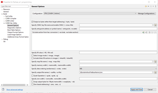

Here below the general settings in "BUILD / C2000 Hex Utility / General Options".
The firmware generated are in the zip attached.

  • The likely fix is to add the option --romwidth=16.  To understand why, please see this forum post.  Though ignore the parts about the length of the line.  That is not a concern here.
    Thanks and regards,
    -George
  • Hi George,
    Is this a workaround to use "-romwidth=16" or an intentional thing that at default it should be preset?
    Otherwise I add that line as you can see:
    The two files are different at the bottom:
    Actually this is not a big deal because I can continue with my work, this was just my curiosity.
    Best regards
  • Is this a workaround to use "-romwidth=16"
    No.  The default is inherited from the predecessor toolchain for C28x, which started in the mid 1980s.  At that time, a default of --romwidth=8 made sense.  It does not make sense today.  But we have learned, over the years, that changing a long standing default creates more problems than it solves.
