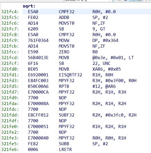

There is a small probability that it will jump into the ILLEGAL_ISR interrupt before and after the sqrt open operation.
After checking the RPC register, the location is at the point where the sqrt function jumps out to the local variable assignment result. However, the customer would like to know where illegal instructions or overflows can trigger an exception to entry.
Entering an interrupt as shown in the figure below is extremely low and will not be possible until approximately one or two days after running, and if you add some uncorrelated code that changes the length and storage location of the .text section. the problem will not occur.

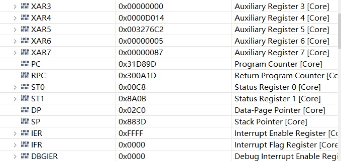

The SP and DP values are as follows:
The customer has already troubleshooting the problem of arrays being out of bounds and not having enough stacks, running a μCOS-II, and then opening 2k space for this task. Is the problem likely to be caused by illegal instructions or incorrect addressing modes? Could you help check this case? Thanks.

  • Hi Cherry,
    When a TRAP ISR is entered the return PC is saved on the stack and not RPC. Can you halt at the start of the Illegal TRAP ISR and read the stack for the return address. The CPU Instruction Set document section 3.5.2, table 3-5 has information on which location on stack has return address.
    https://www.ti.com/lit/spru430
    Customer will need this return address to know where the illegal instruction occurred. RPC only has return address of an LCR instruction hence pointing to the instruction after the LCR and not relevant for last executed instruction.

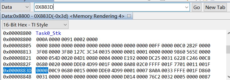

  • Hi Ashwini,
    I'll try to clarify the case here,
    The above screenshots contain stack information when entering an illegal interrupt and the customer has learned from the spru430 doc that the PC pointer before the jump is 0x117701 which appears to be an illegal address. This is also the direct cause of an entry abort. Depending on the RPC value, it can be further confirmed that the PC value in the sqrt function points to 0x117701. This is because the value of RPC will only equal 0x300A1D in the sqrt function, and the probability of this occurring is very low.
    So the customer would like to know under what conditions would cause the PC pointer to jump abnormally to 0x117701 when running in sqrt function?

  • Hi Ashwini,
    The customer has tried to modify the ILLEGAL_ISR content to see the returned PC value obtained, but if the original contents of the ILLEGAL_ISR are modified, the problem does not occur.
    The above figures show the status of the stack, which, according to the doc, is due to the INTR instruction being executed and some of the necessary registers are pushed onto the current stack so we can exclude the stack exception here. The stack for this task starts at address 0x8800 and is 2 KB in size.

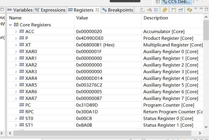

    If none of these help, please can you share the following so I can help confirm the return address stored on stack is illegal address 0x117701.
    1. Snapshot of the Illegal ISR disassembly view from start of ISR to  ESTOP0
    2. Snapshot of the registers with SP and RPC
    3. Snapshot of the stack.

    And customer said all snapshots have already been provided in the original post above. This is the customer's own board, and he believes that if it is caused by a hardware issue, it should be discovered earlier. But in reality, this problem is extremely unlikely to occur.
