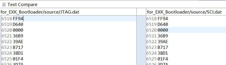

    Can you confirm that when you load the application via CCS, is loads and runs as expected.  If that is the case, let us use CCS to help with this debug.  Have you used the memsave command from within CCS?  Open a memory browser in the memory area of interest (Select View->Memory Browser).  Load the app using CCS,  Use the memsave option from the support available in the memory browser.  It is the green chip with the arrow diagonally across it.  You will be able to save the data to a file.  Repeat the same over the same block of memory after the load via SCI.  Compare the two files...and check for differences.

    I have followed your advices and compared the memory between two download methods.
    I am confirmed that the SCI data stream were completely written to the address since 0x319974( at line 6518).
    This is part of data , which is same as the txt post above.Those address area  is same as  when I load the application via CCS as well.
    There were 4 differences between the two cases , which were very weird.
    I don't know  how it happens?
    comparison table:
    address           CCS load       SCI load
    0x318199        0044              0000
    0x3187fa9       180c              0000
    0x31902a        9600              0000
    0x319175        00b4              0000
    address                order via  sci                                                             order  via ccs
    0x318198:            E2030000    MOV32        @0x0, R0H                      E2030044    MOV32        *-SP[4], R0H
    0x318fa7              761F01BE    MOVW         DP, #0x1be                     761F01BE    MOVW         DP, #0x1be
    0x318fa9:             0000        ITRAP0                                                    180CFFFB    AND          @0xc, #0xfffb
    0x31902a:            5002        ORB          AL, #0x2                               5002        ORB          AL, #0x2
    0x31902b:            0000        ITRAP0                                                  9600        MOV          @0x0, AL
    0x319174:            FFE50000    B            0, LEQ                                FFE500B4    B            C$L17, LEQ
