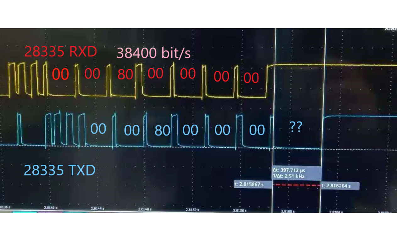

I think there may be a little problem about DSP28335 SCI_Boot and C2Prog.

Hello Wenby,
Can you please provide some information about your hardware?
- is it a TI evaluation board?
- what is the external clock frequency?
- what type of USB-SCI converter are you using?
- are you executing the original SCI bootloader out of ROM?
Also, please upgrade to the latest version of C2Prog v1.8 to see if that makes a difference.
(I just tested on my bench and have no problem programming a TI 28335 controlCard with the latest release.)

Hello Beat,
It's not TI evaluation board. External clock is 30 MHz.
yes,I'm executing the original SCI bootloader out of ROM.
I test with C2Prog v1.8 , the problem still exists,and the oscillogram at the end of booting is the same as v1.7 .
I tried two types of USB-SCI converters , I found the problem had nothing to do with them.

Yansong,
Please contact me at info@codeskin.com - I can provide you with some test instructions and files to further investigate the issue.

Hello Yansong,
As per our offline discussion, the problem is now fixed. I released the updated 28335 programming kernel with C2Prog v1.8.11-6.
