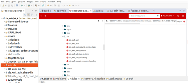

Thanks. Import project manually from <C2000Ware>/driverlib/f28p65x/examples/c28x/cla/
The Resource Explorer doesn't show this project that why we did not find it at first moment.
The project can be imported manually. Will we fix this in next release?

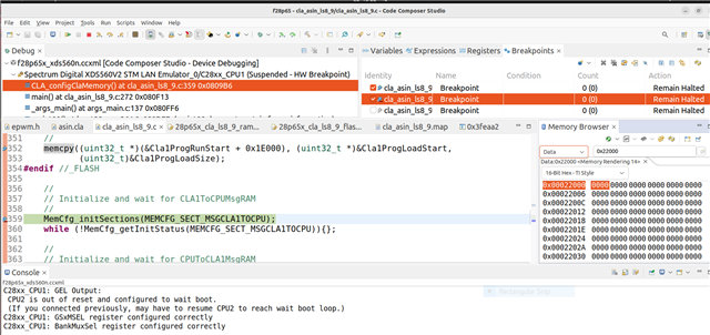

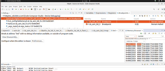

Vivek,
This demo project only work in RAM mode. I set breakpoint at line MemCfg_initSections(MEMCFG_SECT_MSGCLA1TOCPU);
RAM mode.
Flash mode.
Device have to be reset before mode switch to clear LS8 content.
The memcpy() function in Flash mode doesn't work. Security? or anything missing?
Andre
Can you replace the memcpy function call in the code like below and try.
memcpy((uint32_t *)(&Cla1ProgRunStart + (0x1E000/2)), (uint32_t *)&Cla1ProgLoadStart, (uint32_t)&Cla1ProgLoadSize);
Vivek Singh
Vivek,
Changing CLA run address from (uint32_t *)(&Cla1ProgRunStart + (0x1E000)) to (uint32_t *)(&Cla1ProgRunStart + (0x1E000/2)) works.
However I have question, &Cla1ProgRunStart + (0x1E000) should be 0x22000 which is start address of LS8. This 0x22000 is LS8 address before memory remapping. Why do we need to divide the offset 0x1E000?
Andre
Vivek,
More input, Changing memcpy((uint32_t *)(0x22000), (uint32_t *)&Cla1ProgLoadStart, (uint32_t)&Cla1ProgLoadSize); also works.
Looks like compiler issue to generate wrong address &Cla1ProgRunStart? Can you please double confirm?
Andre
Cla1ProgRunStart is 0x4000 because that is CLA address for that memory where as for copy we need to use CPU address which is 0x22000 (0x4000 + 0x1E000). That is why we have to add 0x1E000 to the run address. This is not compiler issue.
Vivek Singh
