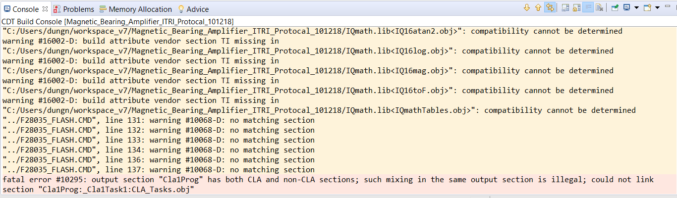

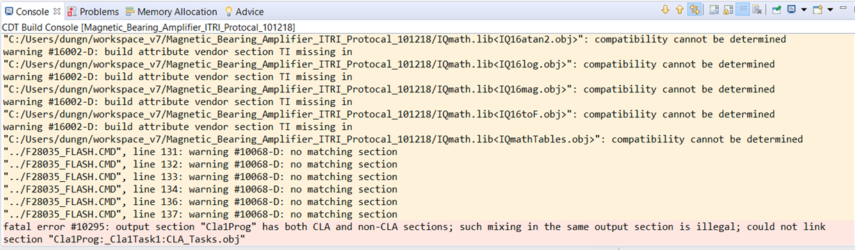

CCS/TMS320F28035: Error: output section "Cla1Prog" has both CLA and non-CLA sections
Part Number: TMS320F28035
Other Parts Discussed in Thread: SFRA, , CONTROLSUITE
Dear,
I would like to run the SFRA+CLA to get the bode-plot of open-loop of closed loop converter. After combining 2 program, I got this problem and I do not know how to solve it. Please help:
Description Resource Path Location Type
output section "Cla1Prog" has both CLA and non-CLA sections; such mixing in the same output section is illegal; could not link section "Cla1Prog:_Cla1Task1:CLA_Tasks.obj" null: output section "Cla1Prog" has both CLA and non-CLA sections; such mixing in the same output section is illegal; could not link section "Cla1Prog:_Cla1Task1:CLA_Tasks.obj" Magnetic_Bearing_Amplifier_ITRI_Protocal_101218 C/C++ Problem
The command file is:

I just modify the original one by adding the SFRA_data. Please help!!!
  • Nguyen,
    It is Thanksgiving week in US. Most of the TI engineers are on vacation. Please expect delay in response.
    I would realistically expect a response back from TI early next week.
    Manoj
  • 1. What is the version of compiler you are using? Can you please use the latest version ?
    2. For the comibnation, which all CMD files you used? We changes CLA compiler methods so I want to make sure you had staretd with something that is good.
  • I use v16.9.6 compiler. About the cmd file. I use the Controlsuite library, then modify it by putting the SFRA data.
  • Can you be specific on the one you tried to use? there are probably 20 CMD files in controlSUITE for F28035
    Also please note we are on v18 of the compiler now!
    Furthermore , please post the detailed log of error
  • The error is shown above. I use F28035_FLASH.cmd. The file is attached and shown in the first question box. Thanks so much for your kind support. Hope this problem can be fixed soon...

       	Cla1Prog         : LOAD = FLASHC, /* Note for running from RAM the load and RUN can be the same */
                          RUN = RAML3,
                          LOAD_START(_Cla1funcsLoadStart),
                          LOAD_SIZE(_Cla1funcsLoadSize),
                          LOAD_END(_Cla1funcsLoadEnd),
                          RUN_START(_Cla1funcsRunStart),
                          PAGE = 0

  • The memory allocation shows this problem.
  • Please anyone can help? Really appreciate!!!
