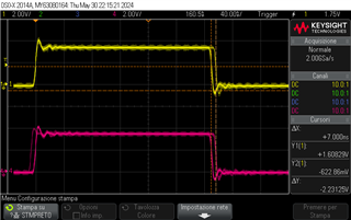

For some values of the variable "periodFineCustom" (so for some value of TBPRDHR) I saw jitters on PWM. I attached a screen of the oscilloscope (EPWM1A: yellow, EPWM1B: pink) and a screen of the corresponding debug view (where you can see also the code modification).
To be honest I read also this post: "TMS320F280049C: Jitter when using HRPWM Period Control" and I tried the suggestion described there in my project but the jitters are still present. Then I tried the example as I described above and again the jitters are present.
What do you think is the root cause?

  • Hi Simone,
    Doesnt look like jitter on the scope. Looks like two waveforms overlapping or running in continuous mode.
    Did you take this scopeshot by stopping the scope plot or was it still running ?
    Reason being that there are two distinct waveforms and not the same waveform going up and down
  • Hi Prarthan,
    thanks for your reply, the graph on the oscilloscope was running.
    The wave is actually the same in two different times, I attach other screens from the oscilloscope if I stop the acquisition instead.
    I took a screenshot of two near period, when the signal is high. In the first you can see a duration of about 251ns, the next period, instead, has an higher duration:
    If you don't stop the acquisition you can see the following image where you can see the different duration (7ns, seems about the duration of a tick):
    It seems that the whole period is larger (compared to the previous, in the same trace I mean):
    Best regars,
    Simone

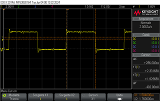

  • Simone,
    I didn't quite understand your question here.
    Please capture two cycles of same waveform in one shot and show the difference between times using cursor.
    What is difference between two screenshots shown above ?
    I captured two cycle of the same waveform in one shot, here you can find the time difference:
    The period is longer because it is longer the time when the signal is high:
    When I say that the waveform is the same at two different times I mean that the square wave is generated with EPWM1 peripheral and the value of the configuration registers does not change but, as you can see in the screenshot, I found that sometimes the period changes. So, in the screenshot, the first cycle has a duration of 500ns and the second cycle has a duration of 508ns. The main difference is that, in the second cycle, the square wave is high for a longer time.
