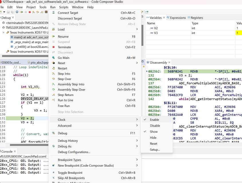

Customer have found that our code takes a long time to run with judgment operation, which is much slower than other operations.
For example:
if (V2 == 1)
V3 = 1;
}This takes 0.1us to run
if ((V4 == 1U) && (V5 == 1U))
V6 = 1;
}This takes 0.142us to run
Customer tried to increase the optimization level, but the time did not decrease. Is there a way to reduce the running time of this logical operation? In addition, do we have a benchmark for logical operations that we can provide to customer?

  • Hi Geodge,
    Customer and I use below method to test the run clock, and below operations will cost 6~7 clock. Is this time can be reduced?
    if (V2 == 1)
    V3 = 1;
    Julia
  • Build with the compiler option --opt_level=2 or higher.  So that the code which uses V2 and V3 is not completely removed, make them parameters to the current function, and pass them on as arguments to some other function.  Put the other function in a different file.
    This change to a higher level of optimization will do it.
