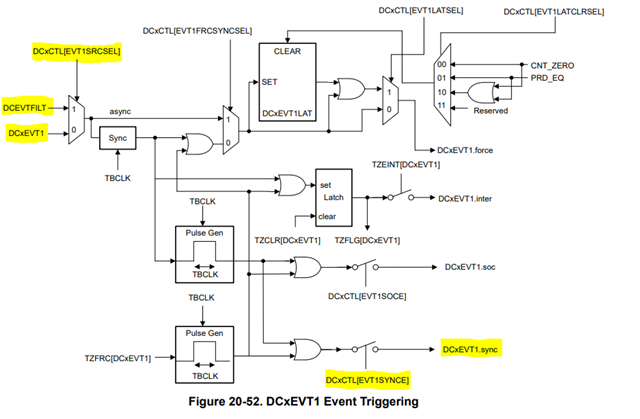

  • Hi Johnny,
    Yes that would be possible using the DC Submodule and syncing the time base submodule based on the CMPSS event.
    Thanks.
  • Hi Prarthan,
    Would you kindly point out what are the registers to use with DC Submodule sync event to sync. the time base submodule, then reset the time base counter ?
    I am trying to configure that.
    Thanks for the input.
    Johnny
  • Hi Johnny,
    Please see the image and corresponding registers/signals highlighted below
  • Hi Prarthan,
    Would you kindly check on is there any problem with below configuration ? Is there any missing ?
    EPwmXbarRegs.TRIP4MUX0TO15CFG.bit.MUX0 = 0; // CMPSS1.CTRIPH
    EPwmXbarRegs.TRIP4MUXENABLE.bit.MUX0 = 1;
    EPwm1Regs.DCTRIPSEL.bit.DCAHCOMPSEL = 3; // use TRIPIN4 as DCA high input.
    EPwm1Regs.TZDCSEL.bit.DCAEVT1 = 1; // DCAH = low, DCAL = don't care.
    EPwm1Regs.DCACTL.bit.EVT1SRCSEL = 0; // DCAEVT1 source is DCAEVT1, not filtered signal
    EPwm1Regs.DCACTL.bit.EVT1FRCSYNCSEL = 1; // source is passed through asynchronously.
    It is set the epwm1.TBPRD to 5khz, and the CMPSS1 input is a 50khz signal.
    Now the EPWM1 is still 5k, not sync. with the CMPSS1 output. It is checked that the CMPSS1 is working well.
    And CMPSS1Regs.COMPSTS.COMPHSTS can be 1 or 0 according to its input.
    Any input or correction on the configuration in bit field ?
    Thanks and regards,
    Johnny
  • Hi Johnny,
    Are you expecting the TRIP input to be low on trip, high otherwise ?
    Please check our c2000ware example, to see how DC and TZ submodule can be configured and then make the following changes on those so it will be easier to get this working.
    Thanks.
