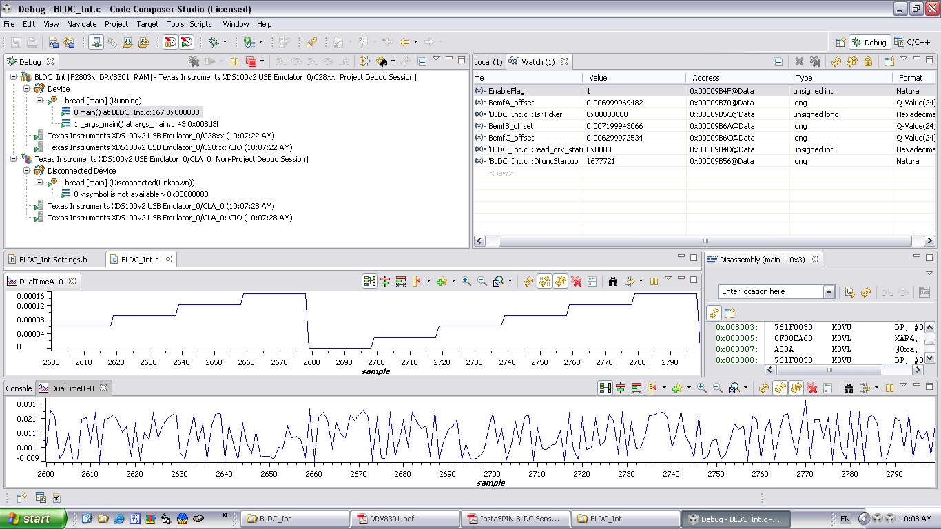

  • Bemf is derived from the voltage sampling. What are the differences between the voltage levels and sampling circuit between the DRV8x kit and your hardware?
    Did you run this motor with the DRV8x HW and the GUI?  I'd be interested to see what the waveforms look like through the GUI and what Vth level you tuned to.
    I think this is one of the first motor solutions where it's actually easier to do all of the development and tuning from the GUI itself.
    Attached is also a "lab" that will be in controlSUITE on the next update. You might find it useful to understand some of the GUI features and how to tune the motor.

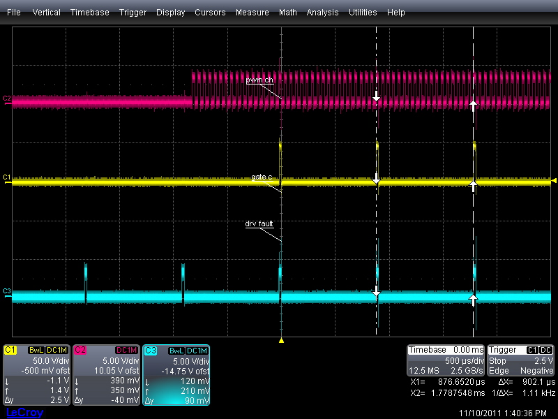

  • Dear Chris,
    I cannot prepare waveform through the GUI because my own design board don't have serial.
    But by  checking/debuging my hardware, we found that the waveform of DRV8301 have something wrong. Please refer to attached file.
    The Eval board, input PWM waveform of DRV8301 same as output Gate waveform of DRV8301
    But My board, input PWM waveform of DRV8301 differ from output Gate waveform of DRV8301 and always have Fault waveform.  *** Refer to attache file.
    We built 4 boards, those are the same problem same waveform. So, I think may something wrong on my hardware.

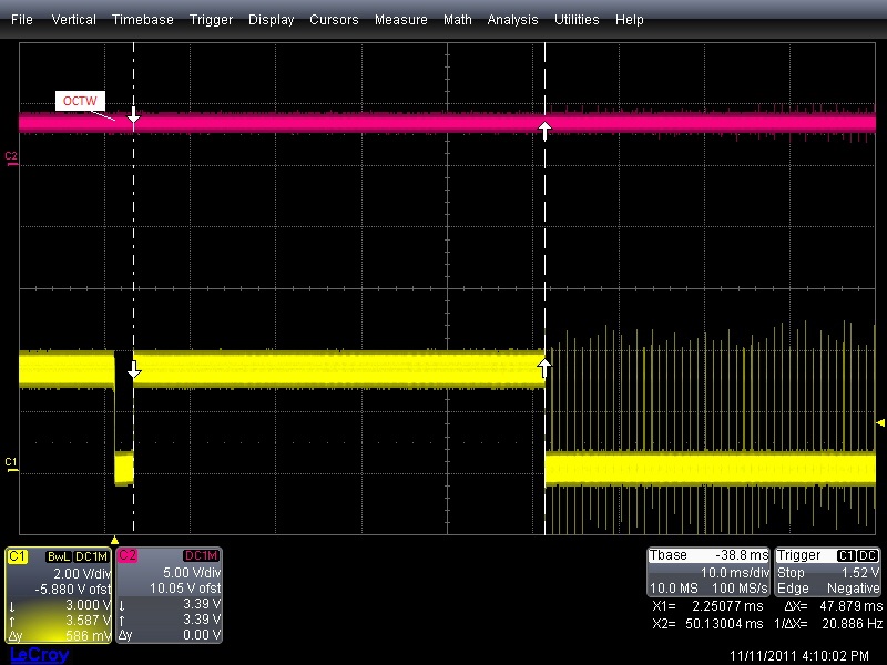

  • Dear Ryan,
    Let you know first, we are testing both Eval & My own design board without connecting Motor.
    By checking OCTW & SPI status register, It's maybe fault mode#2[DVDD undervoltage]. But after check pin DVDD, the voltage is 3.3V which is correct.
    Others pin Voltage are following:
    GVDD =    11.5 V
    CP1    =    0.0 V
    CP2    =    12.0 V
    DVDD =    3.3 V
    AVDD =    6.5 V
    PVDD1=    33 V
    BST_C =    10.5 V
    BST_B =    10.5 V
    BST_A =    10.5 V
    All voltage look OK. So, we don't no why Fault is occured and Gate drive output have no correct waveform. Do you have any others suggestion ??
    I have attached file(CP2_VCC waveform.doc) which is waveform of VCC & CP2 of Eval board and LA board. Both waveform are the same.
    And also attached file(Myboard_Fault_Waveform.jpg) which is Fault waveform since start running code. ***Yellow line is Fault, Pink line is OCTW.
    - Beginning of code, Fault is High. Then DRV8301 is reset, Fault go low then high.
    - After that code delay 50ms then RUN motor control, Fault occur immediately like yellow line in waveform.
    Regarding the SPI, we used the same code except Eval board used SPIA but My board used SPIB. Codes are attached(Code.rar).

  • Sutthinee,
    I am going to need you to look at GVDD, DVDD, and AVDD with a scope to see if they are collapsing.  The decoupling capacitors on those pins are very sensitive to grounding.  The capacitors on those 3 pins need to be as close as possible to the device and the GND side of the capacitor needs to be closely connected to the PowerPAD ground.  Is the PowerPAD of the DRV8301 (exposed metal tab underneath the IC) properly soldered to the board.  This ground pad is the ground for the entire IC and needs to be soldered to the PCB.  The decoupling capacitors for the 3 regulators mentioned above need to be routed closely to this GND point.
    You will actually notice 2 blue wires on the EVM.  These were added as we initially had problems with this same thing on the EVM.  The blue wires bring the GND points from th3 3 decoupling capacitors back to the PowerPAD.
  • Dear Ryan,
    Thank a lot for your suggestion. Now, my board can drive & control motor.

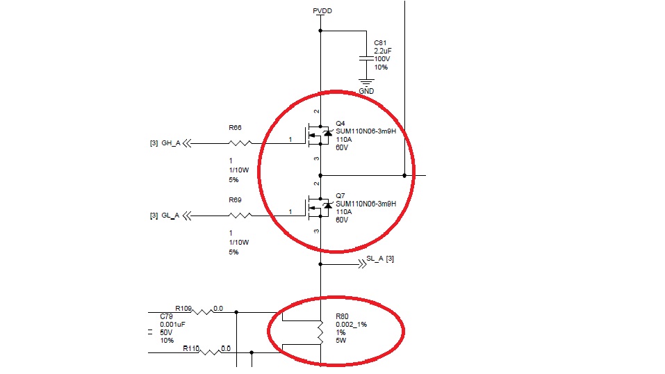

    But I have one more question, Do we need to re-tuning DRV8301 when we change MOSFET ?
    Now,
    - Eval board vs Myboard.  There are 2 differents(R-shunt, MOSFET). Refer to attached file(Eval_mosfet.jpg & Myboard_mosfet.jpg).
    - We are using tuning value which got from Eval to use on my board. We found that compare to Eval board, my board control motor are not much smooth.
    -We think, we need to re-tuning when we change MOSFET & R-shunt.  We trying to tuning parameter relate to MOSFET. But we are not sure we done it all.
    So, Could you please advise what are parameters we need to tuning when we change MOSFET ?  Thank you.

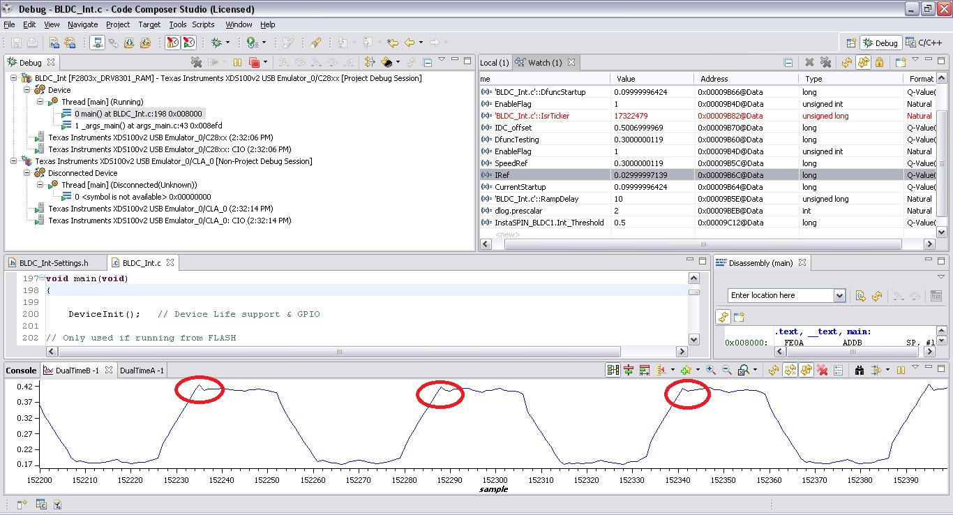

  • Are you using that current sense for a current loop, or just over current protection?
    For tuning the commutation with InstaSPIN-BLDC recall that you are looking at the Bemf value on each phase during the off time.  But you are using a single threshold value for each.  So you should verify
    1. balanced feedback circuits. at steady state are you getting near identical Bemf readings on each leg?
    2. compare this to the DRV83xx board. What are the magnitude of the Bemf. If they are different, why?
    If you are doing a current loop, you should take a similar thought. What is the quality of the current signal you are sampling. Compare it to DRV83xx kit. If it is different, why?

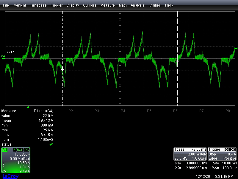

    We are still unclear about the current loop in Level 6. We would like to verify with you.
    What is the relation between variable " IRef " and "actual phase current" at BLDC Motor ???
    For example testing,
    1) DRV Gain = 40, Base Current = 13.75(R shunt =3mA), IRef = 0.1
    The control current should be = 13.75*0.1 = 1.375A.
    But Why the "actual phase current" which we see from scope 's current probe = 22.9A ?
      *** waveform is attached
    2) DRV Gain = 40, Base Current = 13.75(R shunt =3mA), IRef = 0.05
    The "actual phase current" we got = 10A-11A
    3)  DRV Gain = 40, Base Current = 13.75(R shunt =3mA), IRef = 0.025
    The "actual phase current" we got = 5A-6A
    From result above, could you please explain more about relation between variable IRef, Base Current, Actual Phase Current ? Thank you.
    You say your circuit is set-up to scale 0-13.5A, correct?  If there are 22.9A currents how do you expect to represent that on 0-13.5A?  Why did you try to change the base current to a value lower than currents you expect to sample?
    The DRV830x-HC-C2-KIT has a BASE_CURRENT of 82.5A
    That means after the resistor divider (scaling) to the ADC, the maximum voltage to the gain stage will be 0.33.  This gets a x10 gain to 3.3 which is seen by the ADC as 12-bits (code 4096) ideally.

  • No, you are adjusting the wrong values.
    For now just choose one DRV_GAIN and don't touch it. Choose the gain based on the expected peak currents of the system and the resistor divider circuit to produce 0-3.3V at the ADC pins.
    IRef (as I've explained above) is an Id (torque) command only used in one of the control loops (torque mode). Do not START with torque only mode.
    Start with Duty mode.
    Find the Vth value that best commutates your motor.
    Then move on to speed loop commands.
  • Dear Chris,
    Thank you for your suggestion.
    We are followed your suggestion to find the Vth value that best commutates our motor.
    There are 6 values [ 6 waveforms ] which we are comparing. See attached file.
     Could you please help to suggest which waveform(or Vth value) in these 6 values is the best ?
    1616.Vth.rar
    Thank you.
  • in the level 5 files threshold of 0.5 looks the best. What you are going for is a clean 90 degree commutation.  Too early (0.4) and you get the slow roll-off, too late (0.8) and you get that pointed peak.
    What is different in level 6 with the 0.5 threshold? it looks like the same 0.3pu speed.
  • Dear Chris,
    Thank you.
    Yes, Level 5 with Vth =0.5 and Level 6 with Vth =0.5 looks the same. Just have small spike on Level 6.   Do we need to care about this spike ?
    After we got the best Vth from Level5 , we need to use that Vth and dont' touch it.   OR do we need to adjust or re-chose it again when we go thru Level 6-8 ?
  • typically you shouldn't HAVE to "re-tune" your Vth (though you may want to adjust it for high speed operation).
    I would look at level 6 with a slightly lower Vth to see if that little voltage spike changes.  It may just be part of your motor.

  • I am using a DRV8301 board and running the PM_Sensorless project.  I am able to run my Build 5 great which is the closed Current loop with speed estimation and have tuned my PIDs for my application.  When moving to Build level 6, my PID values for the current controlled loop do not seem to be correct anymore when lsw = 1.  The motor will not spin with the level 5 current PIDs. It seems to me that that going from 5 to 6 should not effect my current loop at all.  Any thoughts?
  • I have the same problem which is when ever I set the Enable_Flag to 1, the fault LED lights up.  I looked at the DRV8301)stat_reg1.all and the 9 and 10 bit are set to one which represents GVDD_UV and FAULT are active.  The board was working fine while I running at level 7 of  the PM_sensorless project.  I was running in current mode and switching to speed mode and all of a sudden the board quit working and the fault led lit up.  I have the same problem on another one of my drv8301 and I was wondering what I can do to fix the problem.
  • now it faults on everything? Even after full power cycle and using a known good program (like InstaSPIN-BLDC GUI?)
    if so, it sounds like HW damage (short).
  • Yesterday was the first time that I used this board and it already broke.  I doesn't seem right that the board will short at $300 a piece when I followed the directions from level 1 to level 7 step by step.  Is there anything you can do.  This is my third board already.
  • please try the board with a known working project, and if you can a known working motor.
    the board is very robust and should not be damaged.
    if the DRV device is tripping it's usually one of two things
    - Torque command making a step response: try de-tuning your Speed controller (very low Kp, no Ki) and making your ramp slope shallower
    - If your motor is low inductance it could have some very nasty start-up current spikes. you will need a much higher PWM frequency
  • I tried running the GUI program originally programmed in flash and got the same results (the fault trips).  I know you said that this fault is usually because of two reason but I had the motor spinning successfully on each of my three boards.  Here's what happen when each of the board broke..
    1.)     I was running step 7 and the motor was running fine in current mode, but when I switched to speed mode, the motor stopped and the board fault (which I think is a short).  i went all the way from step 1 to step 7 on this board and used it for over a week.  I was able to switch the board from current control to speed control successfully on this board and I was tuning the PIDs.  The difference between when I switched from current control to speed control the time I broke the board is that I switched while the board was ramping up (at low speeds) and I switched the the speed control.  I didn't think this would short anything because I was pulling such low power.
    2.)    The second board broke the same way with the same fault (GVDD_UV) the first day.
    Both were at low speeds (600 RPM) and low power (1-2 Amps DC) at 57v (too high?).  I should mention that I am using a 3 peak H.P. motor although I never got close to this power.  I changed my switching frequency to 16 kHz because thats what we use today and the inductance is .000206 H.  Can you think of anything I did wrong and hopefully help fix my boards?
  • Kelly,
    Try disabling the OC protection and see if this eliminates the fault conditions you are seeing.
    Write a 0x30 to register 0x02.  Table 7 in the datasheet.
    With such a low inductance motor, this fault can easily be attributed to current spikes.
  • I have tried that already because I saw on a previous post that someone from TI suggested that and it didn't work.
