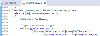

    5. Actually, we are calculating the current vector angle (angleCurrent_rad) below based on the angle MTPA_rad and angle FWC_rad in both motor rotation directions. I have included my observations below; could you kindly confirm if this is the right technique and if any relevant parameters need to be adjusted?
    Here if I decrease the current vector angle (angleCurrent_rad) in negative speed_ref values after crossing the speed_ref = -290f, I am able to achieve the high speed without increasing the supply voltage but in this case, it will inject the negative Id current instead of positive Id current and this is not proper.
    Whether above approach is proper, or we need to tune any parameters related to this because in DRV8353 EVM only we are facing these issues.

  • Disable the MTPA and only enable the FWC for getting the maximum speed, and also you need to make sure that the dc bus voltage and the motor can support the maximum speed with the right load as well. You can't expect the motor can run up to the maximum speed with the same load as the rated or low speed, and also you can't expect the motor can run up to the maximum at a low dc bus voltage.
    Yes. It's for tuning the filed weahening current to achieve the maximum speed if you don't need  the motor to output the high torque at the maximum speed.
    Yes. You are on the right way, you don't need to change anything on the board, just need to tune the field weakening vectore angle to increase the field weakening current. The injected field weakening current will be always negative value.

    2. Without altering the current vector angle, if I use the default current angle generated by the FOC in negative Speed ref after crossing 290f it is injecting positive Id current.
    As you mentioned above it should inject negative Id current right?
    Can you please tell me why this issue is coming and please specify the parameters related to this so that I can resolve this issue.
