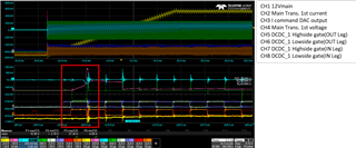

I develop PSFB DCDC converter.
I use reference design TIDM-02000 and use TMS320F280039 MCU.
When DCDC turn on, Main Trans. 1st current peak current  occured.
The I command value calculated by the MCU does not change and maintains a value close to 0.
The Main trans. 1st current increases, but the PWM gate does not turn off and remains on.
I wonder why. If there is anything to check, please let me know.

    In PSFB TIDM-02000, inner current loop is hardware based (comparator based peak current mode control). Initially, PWM of leading leg is 180deg phase shifted to lagging leg (same as shown in scope waveform you have shared). In this case, there is no power transfer. When sensed current is different than commanded current then phase is shift is adjusted using ePWM's cycle-by-cycle trips to adjust current flow in primary so that error can be mitigated. This type of trip resets at every switching cycle.
    I would like to suggest couple of steps for debug,
    1. Could you please cross-check current sensing circuitry to make sure that current signal is properly scaled and going to CMP/ADC input? You can remove shunt and use DC source or function generator to test this.
    2. Internal comparator trip is connected to ePWM trip input?
    3. Please make sure load is set to at least 25% of full load higher load so that current signal can be sensed properly.
    4. Make sure blanking window is set to appropriate value so that there is no false cycle-by-cycle trip because switching transient.
    Let me know if any of these remedies works.

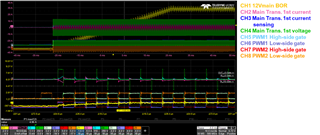

    1. And I checked current sensing signal. This is normal. Please check below CH2 and CH3.
    2. Yes, I know that Internal comparator trip is connected to ePWM trip input.
        Please check code.

    4. I use dcdc switching frequency 55kHz, And I set blanking windows 100ns.
        Could you comment to me how i set  blanking window to appropriate value?

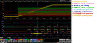

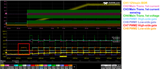

    I enable PWM function below chart.
    If DCDC turn on, enable PWM port first, than PWM forcr trip clear.
    On going PWM function enable, abnormal PWM output.
    You can see red box blow waveform.
    I want know why PWM2 Low-side gate output during PWM function enable.
    Please check.
    I can avoid abnormal PWM output during PWM funciotn enable to change sequence PWM funciotn enable.
