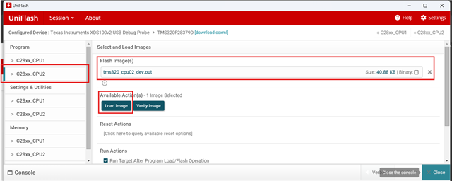

I have develop a application in which i use both CPUs. While debugging code over both CPUs it works fine. but when i try to upload .out file to both CPUs using uniflash, CPU2 doesn't run code. Please let me know if there is any specific procedure to follow. What i am doing currently is I load corresponding .out file in C28xx_CPu1 and C28xx_CPU2 and then press load image button in both tabs one by one. Please let me know where i am doing mistake.

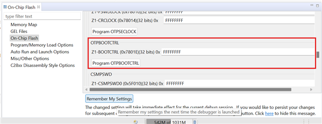

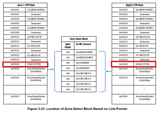

    Please write your configurations to the BOOTCTRL registers in the OTP Flash (0x7801E/0x7821E). Here are the register locations in memory per the TRM:
    You can also try using the DCSM tool (in the SysConfig CPU2 context) or the On-Chip Flash tool in CCS (Connect to CPU2 > Tools > On-Chip Flash) to configure the boot configurations. If you have not looked at this application note, it details how to use the DCSM security tool: https://www.ti.com/lit/pdf/spracp8
    Lastly, I'll also note there's no need to program the Z1 and Z2 OTP registers, as Z2 supersedes the Z1 configurations. I'd advise you to program Z1 first, then Z2.

  • Hello Matt,
    Sorry for asking very basic questions. Please check below image, if this is what you were talking about?
    Kashyap.
  • Hey matt, I tried making that value 0X00000B5A. but still result is same if you need any part of my code or any screenshot please let me know.
    Thank you for keeping up with me.
    Kashyap
  • Hi Kashyap,
    Yes, that is the correct register.

    I am loading my out file in uniflash and directly pressing load image button. is there any setting need to be done?
    Kashyap Vasani
  • Hi Kashyap,
    That looks correct. How are you verifying that CPU2 is not booting to flash? Are you loading the boot ROM symbols to verify the state of CPU2?
