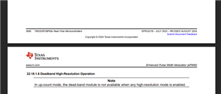

  • Hi Prarthan,
    We have been avoiding up-count since according to the reference manual it does not work with deadband control:
    Can you confirm that HR deadband control and HR phase shift will work together in up count mode?
    Cheers, Bryon
  • Yes I have tried using DBHR and PHSHR in up-count works fine. The note above needs to be revised in upcoming revisions
    Please try and let me know if you have any issues.
