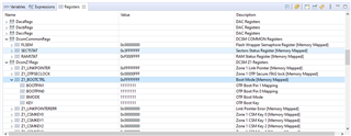

  • Hi Charles,
    I tried the steps you suggested but am still facing some issues:
    1. I am using GPIO 28 and 29 for SCI bootloader.
    2. Initially, I connected the XDS110 to the controller.
    3. I set to debug mode, ran the code, and then went to the registers tab.

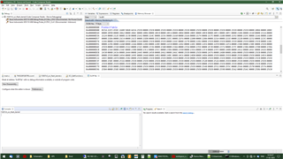

    4. I tried modifying the Z1_BOOTCTRL register as shown in the screenshot.
    5. When I entered 0x5A810010 to set the mode and pressed Enter, the value did not change.
    6. Another method, I tried modifying the specific register in expression window,the value didn't changed.
    Could you please confirm is my procedure right? and if ok kindly suggest how to proceed.
    Thanks!

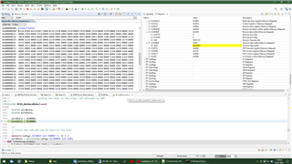

  • What was your reduced or current baudrate?
    I should add that to enter the emulation boot mode for this device, it is explained in section 7.3.2 of the Serial Flash Programming of C2000 Microcontrollers application note.
    0xD00 location should contain the value 0x815A in the Memory browser.
    Z1_BOOTCTRL values can only be modified by programming the OTP through the Flash API, and is not necessary is you wish to succeed doing emulation mode only at first.

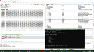

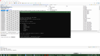

    I followed the steps mentioned below but am facing an issue at the end:
    1.I went to debug mode from the SCI_Flash_kernel example code in Code Composer Studio.
    2.I paused the operation and opened the memory browser.
    3.In the memory browser, I searched for 0x1D00 and updated the first element to 0x815A.
    4.I then did RUN -> CPU Reset.
    5.I pressed the Play button.
    6.I ran the command from the command prompt.
    "serial_flash_programmer.exe -d f2837xS -k F2837xS_sci_flash_kernel.txt -a LED_Blink.txt -b 115200 -p COM9"
    7.The flash kernel got dumped.
    8.I selected option 1 for DFU.
    9.The application code got dumped and asked for next step ,I selected option 6  to run.
    10.It then asked for the address to branch to.
    11.I copied the entry point address from above and pasted it below.
    12.The process gets stuck at “calling f021_SendPacket.”
    How can I solve this issue?
    I also tried this method by setting the SCI boot mode using the GPIO pins, but it didn't work either. Kindly suggest how can I proceed further.

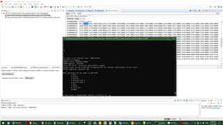

  • Hi Alex,
    No, while working with emulation boot mode, everything works well until the last step. When I select the DFU option, the application code gets loaded, and I am prompted for the next step. I select option 6 to run.
    It then asks for the address to branch to. I copy the entry point address from above and paste it as required.
    At this point, the process gets stuck at "calling f021_SendPacket."
    Even though the process doesn't complete, when I reset the MCU, it successfully boots from flash and runs the application code. So, this issue only occurs when I dump the code using the XDS110 debugger and follow the steps mentioned previously(Modifying code as mentioned above)
    Kindly help me to solve why it is not going beyond first transmission.

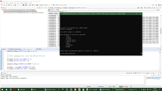

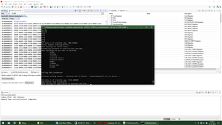

  • Hi Alex,
    Yes I can enable verbose mode by adding "-v" at end. I have attached image of the result
    During my 1st attempt it stuck at 1st transmission and during my second attempt there was an error with autobaud lock echo back.
    And Kindly share If there is  any detailed example code or application note available for changing the boot mode select pins by programming the OTP?

  • Hi Alex,
    Sorry for the delayed response
    Below is the screenshot of the contents of SCI TX and RX buffer as requested.

    I have successfully emulated the BMSP by using value FE5A and 004A , but my doubt are
    1.What value I need to write to  Z1_BOOTCTRL in OTP using on chip menu in debug.
    As per result from EMU boot mode the value is  0x004A 0B5A
    But I noticed the default was 0xFFFFFFFF so as per this I assume the value would be 0xFF4A 0B5A
    Kindly let me know the correct value, so that I can try programming the OTP memory
    Kindly Let me know the solution for why it is failing to run and the correct  value for register.
    You will need to program 0x004A 0B5A into Z1-BOOTCTRL to configure BMSP0=GPIO73, BMSP1=GPIO72, and BMODE=Boot to Flash. You can then boot the device to Flash by enabling GET mode (setting BMSP0 and BMSP1 both to 1).
    Matt
  • Hi Matt,
    Thanks for the response!
    I successfully used 0x004A 0B5A it's working good as expected.
  • Rajamurugan,
    What address does the device branch to after receiving the run command? Does this only occur when branching to the application from the kernel, or also when booting from flash? Can you verify the contents of flash against your .out file using the C2000 Flash Utility "Verify Only" function?

    Setup: Initially, I changed the boot mode select pin using the on-chip flash tool in debug mode so that we could use the default SCI pins for the bootloader.
    Issue: After completing the bootloader process, the RUN command executes successfully, but the application code does not run (it is not transitioning from the kernel to the application code).
    The Entry point address is 0x82c9a for code with FLASHA set
    The Entry point address is 0x82d21 for code with FLASHB set
    This issue occurs only when branching to application from kernel.
    When booting from flash it's working good.

    Please specify address 0x80000 when you command the kernel to execute 6-Run. In general, you'll need to branch to the application's codestart, which is why boot to flash works and the serial flash programmer does not.
    Could you please provide the steps to use the C2000 Flash Utility to verify with my .OUT file ?
    In the On-Chip Flash Tool (found within CCS at Tools > On-Chip Flash when connected to CPU1), you can specify the flash utility to "Verify Only" instead of "Erase and Program" when loading an .out file. Then, you can verify the contents of the flash by loading the application's .out, and confirm that the kernel successfully programmed the flash.
    Matt
  • Hi Matt,
    I tried using this address but it's not branching to flash,

    I also tried using 0x080000 which is mentioned for codestart in code, which is also not working as expected.
    After following the steps as mentioned, I got the below mentioned output.
    C28xx_CPU1: GEL Output:
    Memory Map Initialization Complete
    C28xx_CPU1: Verification-Only step was successful.
    So, as per my understanding the code is FLASH is same as .OUT file of application code
    and the usage of CODESTART address as Entry point address does not work (still application fail to load after bootloader operation)
    According to this why the output address after completing DFU process is not same as the CODESTART.
    Even though this statement is correct, it is still not branching to application code. What would be the actual cause for this issue.
    Kindly provide solution for this issue.
  • Rajamurugan,
    Can you halt the CPU after issuing the run command from the host? What address is it executing from?
    Alex
