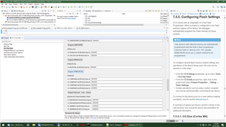

    1.Kindly provide detailed steps to write Z1_BOOTCTRL in OTP using on chip menu in debug you mentioned.
    What value and how I need to program.
    I also have some doubt in On chip flash tool
    Why is device name is different I'm using TMS320F28379S.
    What value I need to program here and in some other post in E2E i saw this "Please note that the Flash API has a 64-bit minimum when programming in order to properly compute the ECC value, so your buffer might need to include some of the surrounding memory." How should I do this.

  • Hi Allison,
    Sure! Thanks for the response. Kindly find the below attached detail for your reference.
    My major concern is,
    What value I need to write to  Z1_BOOTCTRL in OTP using on chip menu in debug.
    As per result from EMU boot mode the value is  0x004A 0B5A
    But I noticed the default was 0xFFFFFFFF so as per this I assume the value would be 0xFF4A 0B5A
    Kindly let me know the correct value, so that I can try programming the OTP memory
