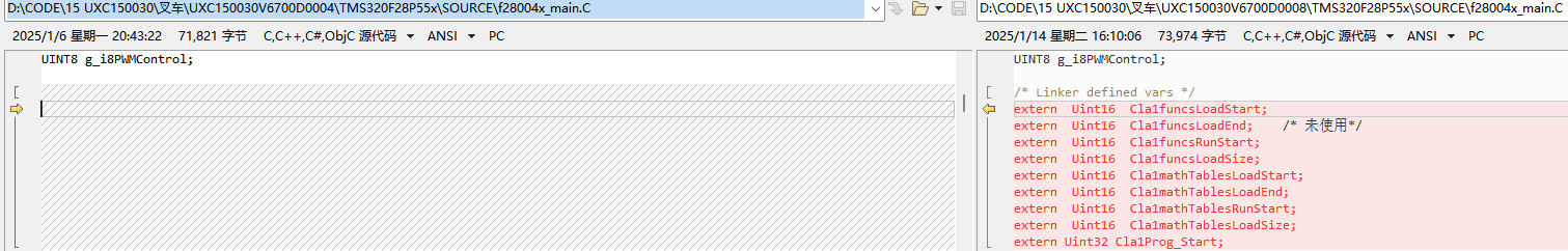

My customer used CCS12.8.1, and modified the CLA configuration and cmd file, and program the .out
file into Flash. He found when power up the board(not our EVM), the program ran out, and could not erase the Flash correctly. Below figures show what he changed in codes. Could you help look into this issue? I can send you the whole project if you need. Many thanks.

    Can you confirm if the customer has updated their linker command file to account for the CLA? If not, have them refer to the example linker command files in C2000Ware under: device_support\f28p65x\common\cmd\f28003x_cla_c_lnk.cmd
    I'm not sure how they've configured it, but please let them know they need to carefully map the linker command file memory sections to the MemCfg functions in the initCLA() routine.
    See libraries\math\CLAmath\c28\examples\common\f28p65x_examples_setup.c
    - configCLAMemory() -> this function CLA program and CLA Math tables into RAM and configures the RAM blocks for CLA execution
    The two files go hand in hand and I suspect the customer hasn't configured them correctly.
