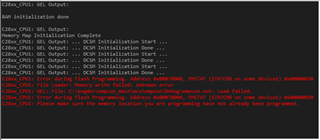

I have a question regarding setting up the DCSM OTP so that the device standalone boots from Flash.
I understand that the Boot Mode Select Pins for the F28003x MCUs are defaulted to GPIO24 and GPIO32 and that these should be pulled HIGH to set the boot mode configuration to FLASH. However, I would like to utilize these GPIO pins for other functions, so I am attempting to configure the boot mode per section 4.5.3.1 Zero Boot Model Select Pins in the TMS320F28003x TRM in addition to the DCSM Security Tool guide SPRACP8A, but I am getting the following error when attempting to flash.
I am setting the ZONE1 header in sysconfig to use 0 Boot pins and for the BOOTDEF0 to be FLASH entry address 0x00080000. I am not configuring the Linkpointer and I am leaving Zone 2 as is. This is the first time I have attempted to flash a build that incorporates the dcsm.asm and dcsm.cmd files generated by sysconfig, so I don't get why it is informing me that I am attempting to program locations that have already been programmed.
Possible causes/fixes for this error?
Is there a method for retrieving the DCSM OTP settings in realtime from the device?
Current Sysconfig Settings:
Keep in mind that I am using v4.03.00 of C2000ware and v12.3.0 of CCS.
Appreciate any help.
  • Hi Jacob,
    Apologies for the delayed reply. I am confused as to why you are seeing this error as well. Could you connect to the device and look at the memory browser at address 0x78000 onward and send a screenshot of what you see?
    Thank you,

  • Luke,
    See the screenshots for what you requested below:
  • Hi Jacob,
    Perhaps your dcsm.asm file is attempting to program all Fs at address 0x78004. Could you share the generated dcsm.asm and dcsm.cmd files as well?
    Thank you,
    Luke
  • Luke,
    See below.
    dcsm.cmd:

    dcsm.asm:
    ; Zone 1
    ;;     .sect "dcsm_otp_z1_linkpointer"
    ;;      .retain
    ;;      .long 0x00003FFF
    ;;      .long 0x00003FFF
    ;;      .long 0x00003FFF
         .sect "dcsm_otp_z1_jlm_enable"
          .retain
          .long 0xFFFF000F     ;Z1OTP_JLM_ENABLE
    ;;     .sect "dcsm_otp_z1_jtag_pswdh"
    ;;      .retain
    ;;      .long 0x4BFFFFFF     ;Z1OTP_JTAGPSWDH0
    ;;      .long 0x3FFFFFFF     ;Z1OTP_JTAGPSWDH1
         .sect "dcsm_otp_z1_cmac_key"
          .retain
          .long 0x00000000     ;Z1OTP_CMACKEY0
          .long 0x00000000     ;Z1OTP_CMACKEY1
          .long 0x00000000     ;Z1OTP_CMACKEY2
          .long 0x00000000     ;Z1OTP_CMACKEY3
         .sect "dcsm_otp_z1_pswdlock"
          .retain
          .long 0xFB7FFFFF
         .sect "dcsm_otp_z1_crclock"
          .retain
          .long 0x7FFFFFFF
         .sect "dcsm_otp_z1_gpreg"
          .retain
          .long 0x5AFFFFFF     ;Z1OTP_GPREG1 = Z1_BOOTPIN
          .long 0x5AFFFFff     ;Z1OTP_GPREG2
          .long 0xFFFFFF03     ;Z1OTP_GPREG3 = Z1OTP_BOOTDEF_LOW
          .long 0xFFFFFFFF     ;Z1OTP_GPREG4 = Z1OTP_BOOTDEF_HIGH

  • Hi Jacob,
    I see the issue. Your linkpointer values are commented out in dcsm.asm. When this happens, CCS will attempt to program all Fs at address 0x78000 which will fail since you cannot program bits to a 1 if they are already programmed to a 0.
    To fix this you must enable the Zone Header block in SysConfig so that the linkpointer values will not be commented out in your generated code. Make sure you do not program any values in the zone header with unintended values since they will be permanently programmed on the device (with the exception of JTAGLOCK / JLM_ENABLE)
    Thank you,
    Luke
  • Luke,
    After implementing your suggestion for modifying the sysconfig file to include linkpointer values, I am still seeing a flash error unfortunately. However, I am not seeing the error that I am attempting to program memory locations that have already been programmed now, so I think its a step in the right direction. See below for flash error:
    My sysconfig file is as follows:
    And the new resulting dcsm.asm and dcsm.cmd files are below:
    dcsm.asm:

  • Have you changed any settings under "Configure Boot Setting" in SysConfig(inside of Zone Header block)? It seems you have already programmed the GPREG block which is affected by these GUI fields.
  • This is the first instance that I have tried to flash the MCU with "Configure Boot Setting" Sysconfig fields populated, so I'm not sure how this OTP would have been programmed already if that's the case. Is there any way to check the contents of the GPREG block to see if it is configured for Zero BMSP and to boot from flash?
    If Zone1 has been programmed somehow, then if Zone2 is programmed this should override the settings in Zone1 correct? So, I could potentially still be able to configure this as Zero BMSP to boot from flash by programming the Zone2 header?
  • Hi Jacob,
    You can confirm whether values have been programmed at GPREG by observing the contents of the memory browser starting at address 0x78000. Could you take a screenshot of this and share it on this thread?
    You're correct, programming custom settings in zone 2 will override settings in zone 1, however I'd recommend not doing this until you confirm what is going on with zone 1 and save the zone 2 method as a last resort.
    Thank you,
    Luke
  • Luke,
    If I try to program with the dcsm .asm and .cmd files included in the build, then I receive the flash program error that I have posted below and the memory browser is blank.
    If I exclude the dcsm .asm and .cmd files from the build and flash, then the memory browser does populate with the values shown below after the flash operation is complete.
    Jacob
  • Hey Jacob, it appears you've programmed custom GPREG values at addresses 0x7800C and 0x7800E. You won't be able to reprogram the GPREG values with your current .cmd and .asm file.
    If you uncheck "Configure Boot Setting" in SysConfig, do all of the GPREG values get commented out in the generated dcsm.asm? This is the expected behavior. If this is the case I'm not sure how the GPREG values would've been programmed with the 0x5AFFFFFF values you're seeing in the memory browser.
    Thank you,
    Luke
  • Luke,

    My only course of action now would be to flash to the Zone2 location with the desired header and linkpointer values correct?
  • Yes, programming custom boot settings in Zone 2 will override the custom settings in Zone 1. After this the boot settings will be permanent.
    To test your boot configuration you can use emulation boot before programming the values permanently in OTP.
    Thank you,
    Luke
