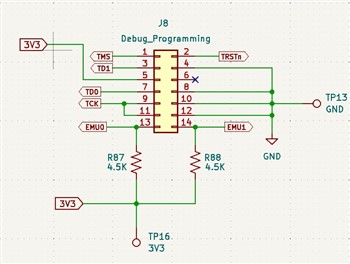

I have developed a Custom PCB based on the F28335PTPS microcontroller and am using the TI XDS 110 Debug Probe for JTAG debugging. While generating waveforms at a specific frequency, I’ve observed that the output frequency on the hardware is approximately one-third of the expected value. However, when simulating the same setup in Simulink, the output frequency is correct.

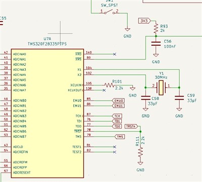

Upon further investigation, I noticed that the crystal frequency, as observed on the DSO, fluctuates rapidly between Hz and MHz instead of maintaining a stable value. This irregularity leads me to suspect there might be an issue related to the clock configuration or the crystal itself.
I’ve attached the schematics for your reference. I would greatly appreciate it if you could provide insights into potential causes and suggestions to resolve this issue.

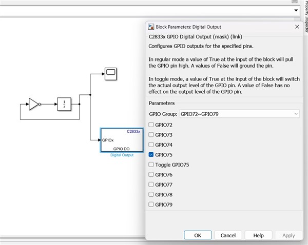

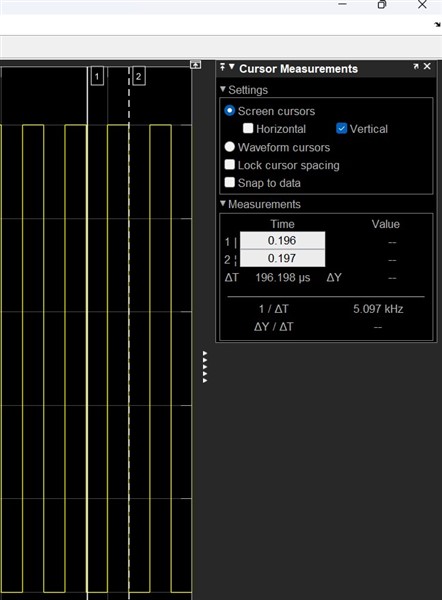

’m trying to generate a 5 kHz signal using GPIO and EPWM , and while the Scope shows the correct 5 kHz frequency, the hardware output shows around one-third of that frequency. There’s no PLL involved in the setup. i have attached scope output and code images.
Hi Atul,
Can you please help clarify what you are scoping and what you mean by 'hardware output'? Are these two different sources?
What is your clock configuration setup?

I’m generating a 5 kHz signal, and it shows the correct frequency on the Scope. However, when I dump the code into the MCU (F28335), the frequency becomes one-third of the expected value. hardware output means output from MCU after dumping code and from same sources. and both of these methods gives me one third of that frequency.
What are your SysCtrl settings i.e. how do you initialize the peripheral clocks? The frequency being 1/3 the expected value makes me suspect that the code is assuming a 10 MHz clock, not 30 MHz.
Matt
