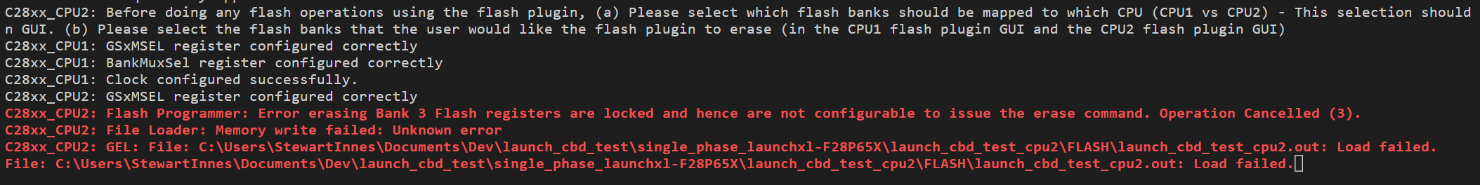

Try to open a GUI Composer program, and realize that it tried to flash the program again (despite `symbolsOnly=true` in the gc-model-program) and failed:
So we try the previous steps again
  • Start debugging
  • Connect both cores
  • Check configuration is still good
  • Configure clock
  • Run, then load CPU1
  • Check CPU2 configuartion
  • Run, then load CPU2
  • Fail:image.png
Power cycle, try again, it still fails. Eventually I can try to flash and reflash and get it to work, but it's about 1 in 10 attempts.

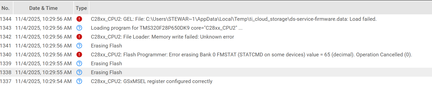

A couple of things I've noticed that could be clues:
  1. When I flash CPU1, the popup in the bottom right corner will say something to the effect of "Erasing Bank 0", then "Erasing Bank 1", then 2 and then also 3 briefly before continuing on - despite bank 3 being configured for CPU2 and not checked to be erased with CPU1
  2. If I do a "Blank Check" in the error state, this is the message: C28xx_CPU2: Flash Programmer: Error during Blank Check @ address 0x00080000; expected 0xFFFFFFFF, actual 0x00000000 (0).
    Does that suggest that the "erase" function is filling with 0 instead of F? Is that a configuration option?

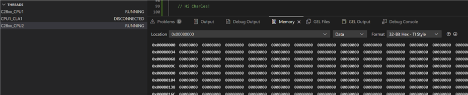

    This suggests that CPU2 does not have ownership of Flash Bank 3 (0x0000 values seen in CPU2 Flash Memory window view). Can you provide confirmation of the memory window for CPU2 at Flash Bank 3 address, as well as the current Flash Bank owners through BankMuxSel in register view?

  • I believe this has all the version info you could need, but let me know (how) if you need any more.
    The memory view for CPU2 is all zeros:
    whereas the memory view for CPU1 is not:
