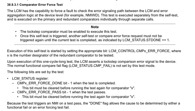

    So I read the technical manual and just to clarify my understanding to demonstrate the lockstep working I need to add LCM.c and LCM.h in any driverlib project and I can use the Comparator Error Force test using a GPIO input button which sets the LCM_CONTROL.CMPx_ERR_FORCE bit which in-turns  trigger an NMI and write my own ISR and read the LCM_STATUS to identify that the interrupt was trigger due to CMPx_ERR_FORCE_DONE bit is set.
    Is this correct?
  • I can use the Comparator Error Force test using a GPIO input button

  • Yes i read that example but in that as well I was not ablt to generate the NMI even after adding the
    Interrupt_register(INT_NMI, nmiISR);
    So instead trying that I went to try "Comparator Error Force Test" which if passed triggers an nmi right?
    So as mentioned in the document I locked the the LSEN configuration-> then enabled the comparator in the CPU2 code. All the basic functions are called properly.
        EALLOW;
        HWREG(CPUSYS_BASE + SYSCTL_O_CPUSYSLOCK2) |= SYSCTL_CPUSYSLOCK2_LSEN;
        EDIS;
        LCM_enableLockstepCompare(LCM_CPU2_BASE);
    cleared the flags then  called the comparator error force test function
    LCM_runComp1ErrorForceTest(LCM_CPU2_BASE);
    ( this is done without debugger and i have inited the interrupt vector table)

  • So instead trying that I went to try "Comparator Error Force Test" which if passed triggers an nmi right?
    Yes you should see NMI getting triggered if debugger is not connected.
    The self test application also has compare error force test check in addition to self tests, Please check the self test application.

  • Hey there,
    So read the self test application and with the reference to it used the files sta_main.c and sta_testd usign the lines given below:
        DINT;
        Interrupt_initModule();
        Interrupt_initVectorTable();
        // Clear ALL NMI flags BEFORE enabling NMI
        EALLOW;
        HWREGH(NMI_BASE + NMI_O_FLGCLR) = 0xFFFF;
        HWREGH(NMI_BASE + NMI_O_CFG) |= NMI_CFG_NMIE;
        EDIS;
        // Initialize vector table and register NMI handler
        Interrupt_register(INT_NMI, &nmiISR);
        // Enable interrupts
        EINT;
        ERTM;
    //enabled the LCM
    //enabled the comparision
    HWREG(LCM_CPU2_BASE + LCM_O_CONTROL) |= LCM_CONTROL_CMPEN;
    // cleared the gflag
    HWREG(SYSSTAT_BASE + SYSCTL_O_LCM_ERR_FLG_CLR) =
    SYSCTL_LCM_ERR_FLG_CLR_GERR | SYSCTL_LCM_ERR_FLG_CLR_CPU;
        EALLOW;
        HWREG(LCM_CPU2_BASE + LCM_O_CONTROL) |= LCM_CONTROL_CMP1_ERR_FORCE;
        EDIS;
     still the NMI is not getting triggered.
