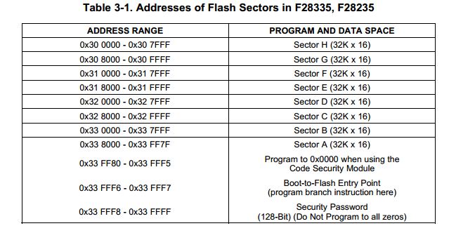

I want to write 256 uint16 values into flash memory SECTOR_B using Flash2833x_API_ReadWrite() library.
It is possible to write so many values without damaging any code or data.
Until which address I can write on SECTOR_B.
Paul.
  • Hi Paul,

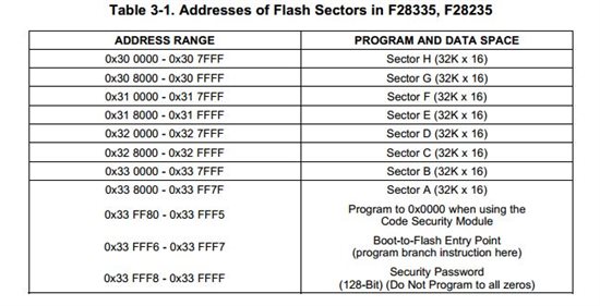

    Here's the flash structure for F28335:
    256 uint16 values : for sure, you should be able to write them. Do try and let me know.
    You can utilize the complete range: 0x33 0000 - 0x33 7FFF
    Gautam
