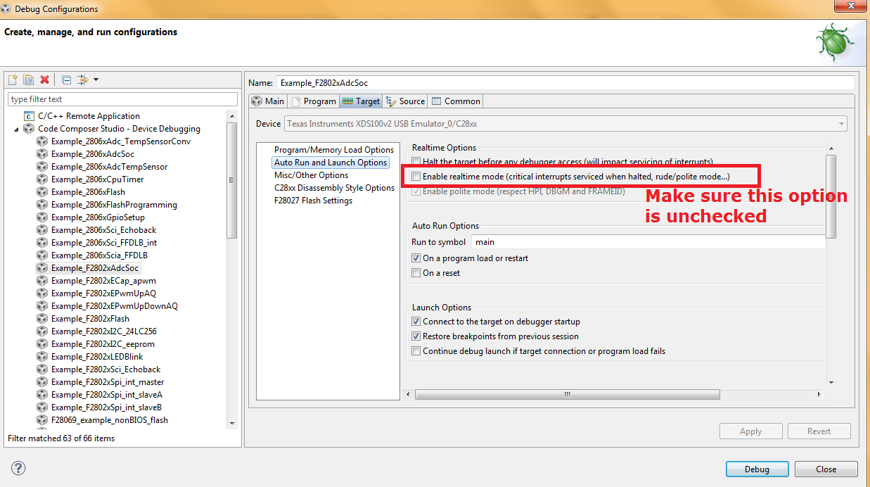

  • Also one more thing, in "Debug Configurations" menu (Run --> Debug Configurations --> Target --> Auto Run and Launch Options), please make sure that "Enable realtime mode" is unchecked.
    Maria
  • Hi Maria,
    I am using CCSV5. In debug options menu only " Enable polite mode" available and its checked. There is no option (as I see) Enable real time mode icon. I tried to paste "CPU_enableDebugInt()" function to my code. Some errors and warnings is appeared in console. I tried but I couldnt add this function.
