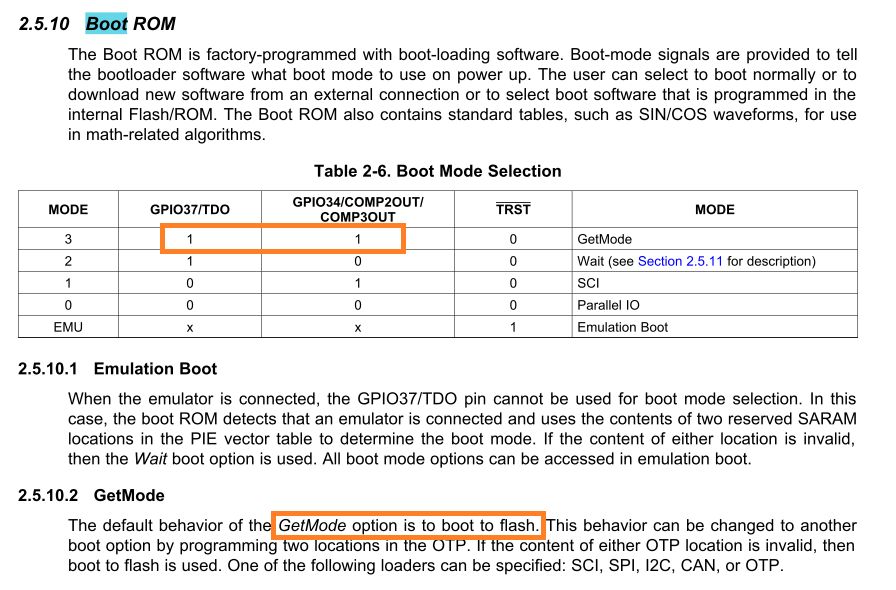

3.- I do not understand what boot mode jumpers are. This is the grayest area to me. I'm a control stick or launchpad or anything like that. How do I go about these jumpers?

    3. This information is from F28069 but it is the same for F2802x. You need to pull up TDO and GPIO4 (you can see the schematic of launchpad about how to connect it C:\ti\controlSUITE\development_kits\C2000_LaunchPad\LAUNCHXL-F28027\HwDevPkg).

  • When you say pull up.. do you mean doing this in software? It would be kinda hard for me to physically do this since I already have my chip on a PCB. I made the PCB very much how the launchpad was setup.

  • Hello Alan,
    If you have made your hardware based on Launchpad, then you can check whether these 2 pins (TDO and GPIO34) has been made like in Launchpad.
    This pull up should be made in the hardware so you can boot from flash when you run in standalone (= without emulator).
    I am sorry that I have no experience to change these pins in PIE vector Table. You can do your experiment and share us your result.
    And also try the flash example that Gautam mentioned, If it works, then I am almost sure your hardware is fine.
