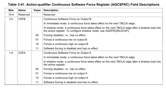

I have the need to change run-time the period of two syncronized EPwm,
but before to do this operation I have to force LOW out A and out B not immediately
but syncronously (for example "on event counter equals zero").
To force LOW out A and out B I use bit CSFA and CSFB in the AQCSFRC register.
To do this operation syncronously I use bit RLDCSF in the AQSFRC register:
Is there a problem:
when I write "1" to CSFA,CSFB register out A,B are not set to immediately to zero,
so I can't change EPwm period immediately.
If I want to change EPwm period I have to wait CSFX effect (i.e. out X forced LOW).
Is there a way to wait this event, for example ...
While(EPwmXRegs.XXXXX.bit.YYYY==1) asm(" nop");
For now I use this code but it is not the best
While(EPwmXRegs.TBCTR>4) asm(" nop");
Can some one help me ?
  • I've try this code but I notice a problem:
    		EPwm5Regs.ETPS.bit.INTPRD	= 1;//Generate an interrupt on the first event INTCNT = 01 (first event)
    		EPwm5Regs.bit.INTSEL			= 1;//Enable event time-base counter equal to zero. (TBCTR = 0x0000)
    		EPwm5Regs.ETSEL.bit.INTEN	= 1;//Enable EPWMx_INT generation
    		EPwm5Regs.ETCLR.bit.INT		= 1;
    		//EPwm5Regs.ETCLR.bit.INT		= 1;
    		while(!EPwm5Regs.ETFLG.bit.INT) asm(" nop");
    If I call EPwm5Regs.ETCLR.bit.INT = 1 once EPwm5Regs.ETFLG.bit.INT is NOT cleared,
    so I have to call EPwm5Regs.ETCLR.bit.INT = 1 twice
