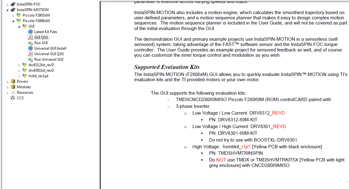

I'm using for the first time MotorWare. Also I'm trying to test for he first time the TMDSHVMTRINSPIN kit. I have a few questions.
-Where I can find the pdf that shows the circuit board connection for my device and for my kit. Does these PDFs exist? And the info in the USB that came with my device has old software and PDF-documents for MCUs which do not correspond.
In MotoroWare is a Quick Start Guide, not clear at all.
All this can be found in MotorWare->InstaSPIN_MOTION->Piccolo F2806xM->GUI ->GUI QSG
Which range do you have in mind for low voltage -high voltage and low current- high current?

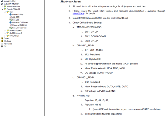

- I couldn't find the meaning of the next setting:
  • JP1: VR1-Middle ( Does this jumper exist?!  What does VR1 Means? )
  • JP2: Populated ( this jumper has three pins, how should it be populated?! )
  • M1: High-Middle ( What does M1 plus High-Middle mean? )
This last two lines. Give me no idea of what they talk about.

    There are many Quick Start Guides in MotorWare. You need to review the correct ones. I would suggest:
    - Kit Readme First
    - HW Guide for the controlCARD you are using.
    - HW Guide for the HVKIT
    - GUI Quick Start Guides (either FOC, MOTION, or UNIVERSAL depending on what you want to do)
    Then start working through the labs using the Projects & Labs User's Guide
    each of the kits has their own Voltage and Current specification. You should review from their webpage folder or the HW guide if you are unsure.
    This is for the DRV8312 EVM. You should ignore since you have the HVMTR kit presumably.
    • DC voltage to J9 or PVDDIN
    • DC voltage to PVDD and GND
    ...to be clear they should be using the prefix Main or M1 or M2, etc.
    Again, this is for the DRV8312 EVM

  • with CNCD28027 you have the jumpers correct as is per the docs
    For controlCARDs without on-card isolated emulation, ex: TMDSCNCD28027F: a. Do NOT Populate M3-J5 (enables power to HVKIT emulator)
    b. Populate J9 (enables JTAG connection) when running projects from MCU RAM

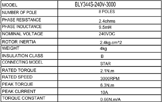

    Does #define USER_MOTOR_MAX_CURRENT (10) is right for this motor?
    I blew up the fuse 10A-250V (LT10AL250V) what is wrong? Could the AC rectifier be damaged?
    Should I use a fuse less than 10 A to protect the Yellow-PCB?
    Uriel P.
    I doubt your induction motor is 10A capable.  You should know the rated current of the motor. Yes, it is a good idea to limit this.  Try 5A

    re: your user.h
    I assume this is a normal 50 Hz type of induction motor. If so, let's update these values.
    #define USER_MOTOR_FLUX_EST_FREQ_Hz (5.0)
    #define USER_MOTOR_MAX_CURRENT (4.0)
    why don't you have a value for this, it should have been ID'd
    #define USER_MOTOR_MAGNETIZING_CURRENT (NULL)
    based on this
    #define USER_MOTOR_RATED_FLUX (2.9938)
    you have a 220Vac motor, so it is expecting ~350Vdc. You only have half the bus voltage required when you use the AC/DC rectifier from 115ac. It should ID and run fine at lower speeds, but won't go above about 20 Hz.
    #define USER_ADC_FULL_SCALE_VOLTAGE_V (400) // 409.6 hvkit_rev1p1 voltage scaling
    #define USER_ADC_FULL_SCALE_CURRENT_A (10) // 19.89 hvkit_rev1p1 current scaling
    DO NOT CHANGE THESE VALUES. Put it back to 409.6 and 19.89!!!! This is a major problem
