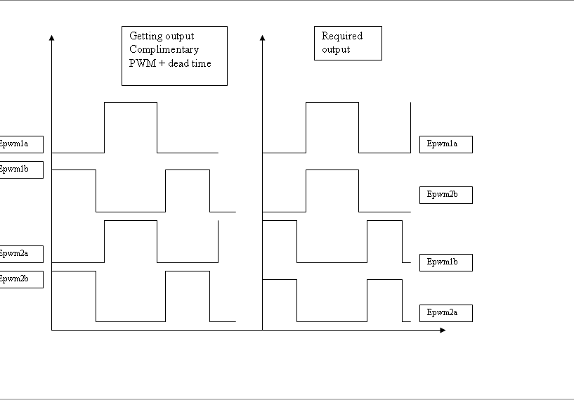

Dear All,
I use the ePWM module from F28069 and i have to generate the two sets of complimentary PWM signal with dead band (EPWM1A, EPWM1B & EPWM2A, EPWM2B).
But i want
 EPWM1A, EPWM2B signals start at same time(synchronous) , EPWM1A, EPWM1B signals complimentary with dead band.
EPWM1B,EPWM2A at same time synchronous),EPWM2A, EPWM2B signals complimentary with dead band.
Because to drive H BRIGE converter
  EPWM1A,EPWM1B signals are connected in series of switches s23 and s73  in left side leg of  Hbridge  inverter
  EPWM2A,EPWM2B are connected in series of switches s24 and s74  in Right side leg of  Hbridge  inverter
for one cycle EPWM1A and EPWM2B should ON
For other cycle EPWM2A and EPWM1B should ON
I configured the both PWMx as active high complimentary and configured the deadband full enable. But i did not get the proper output.
This is the PWM configuration source code

  • Hi Gautam,
    Now i got the required two complimentary PWM with dead band signals.
    In that previous code i changed the configuration for  both PWM as active high complimentary and changed the action qualifier settings.
    Action qualifier settings should same for EPWM1A and EPWM2B (AQSET & AQCLEAR)Also same settings for  EPWM2A and EPWM1B(( AQCLEAR& AQSET ).
    I took the reference  DeadBand PWM project from F28069 control stick program and configured settings as mentioned above it is working fine.
