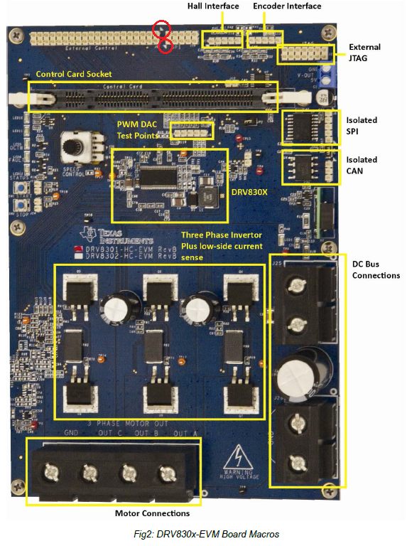

I'm using a TMDSCNCD28069MISO Piccolo F28069M controlCARD with DRV8301, with an Avago HEDS-5640 encoder.
When I try to do lab 12a (encoder connected), the motor doesn't spin. I have verified that the motor does spin without the encoder connected.
I am fairly certain that the cables are connected in the right way (at least if the GND pin is the one the farthest away from the J4 text on the inverter board).

In looking at the datasheet for the HEDS-5640 encoder, it seems like the pinout for this encoder is as follows:
1 -> GND
2-> Index
3 -> Ch A
4 -> Vcc
5 -> Ch B
While the pinout for J4 on the DRV8301 kit is as follows:
1 -> Ch A
2 -> Ch B
3 -> Index
4 -> Vcc (+5V)
5 -> GND
Have you corrected the cable so that the pins line up? It seems like the encoder isn't reading anything. Another test would be to use an oscilloscope on the encoder lines to make sure that when you spin the motor by hand, the encoder is sending out pulses.

The vibration/noise means that there is an issue between the motor and the encoder. So the FOC software is not getting a good angle to do motor control from. Typically we see this if the encoder direction and motor direction are not aligned, if the encoder has the wrong number of counts configured, or if there is excessive noise on the encoder feedback lines.
