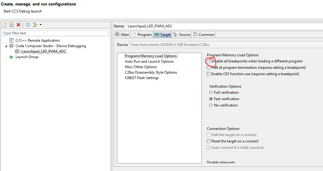

  • Hi I tried putting just 1 break point it did not work.
    But fortunately I think I found the problem .
    In the debug configurations, under the Target settings.
    I unchecked the " Disable all the breakpoints when loading a different program " button and now the break points work just fine.
    Many Thanks,
    Ishan

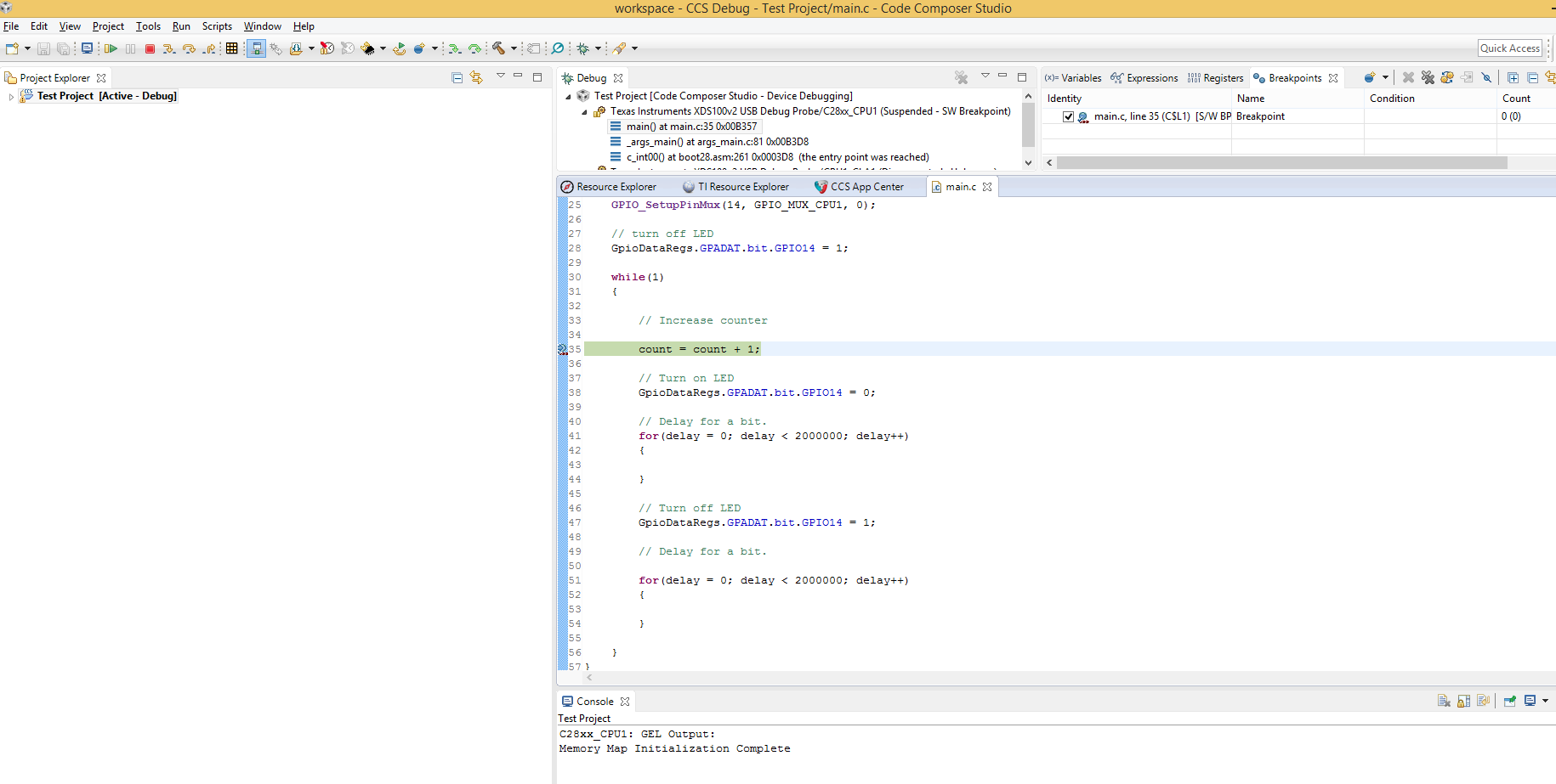

  • I have the same problem with breakpoints. I am running a simple code to toggle an LED on and off.
    I have a variable called "count" in a loop that toggles an LED on and off.
    I set a breakpoint next to count, in hopes that each time through the loop the code would stop at count, where the breakpoint is. Instead, the code runs continuously, and in my expressions window I can see count increasing, and my LED continues to flash (meaning the code is successfully executed).
    I made the menu setting above:
    but my code still does not stop at the breakpoint.

  • Are you running the code from RAM or Flash? When you set the breakpoint, do you get any message in console window? If you can post the snapshot of CCS project view after setting the breakpoint, it will be helpful
    Vivek Singh
  • Attached is a screenshot of my workspace.
    I have gotten this to work now.
    This is what I did, which didn't work:
    I would set a software breakpoint, debug the code, and then not be able to pause/resume the code at the single breakpoint I had.
    This worked:
    I debugged the code, and then after debugging, I set a breakpoint in the code, and I could pause the code at the single, and then multiple breakpoints.
    I am not sure how I know if the code is set to flash or ram though. How do I know this?
  • Good to know you got it working. Look like you are loading the code into Flash but running from RAM which means during runtime code gets copied into RAM and then get executed. In this case if you set the breakpoint upfront then it'll not work because breakpoint info get lost during copy code so you need to set the breakpoint after copy code is done (like you did now).
