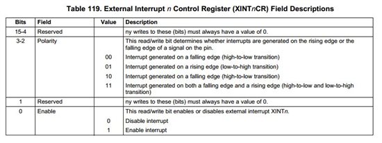

    Refer External Interrupts section in SysCtrl and Interrupts User manual of your device. Also, here are the options:
    Gautam
  • I know these registers Gautam, but what I am asking is how to know specifically if it triggers on rising edge and falling edge. I can read the polarity bit but it only tells me that the value is 3 which is trigger on both edges.
