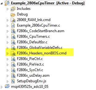

    However, I'm wondering about the F2806x_Headers_nonBIOS.cmd file.
    Should it be left on the file system of the project, or defined inside the project properties somehow (maybe under "Linker->File search path->Include library or command file " ?
    If I look on a ControlSuite project, this file is not defined in the project properties.
    Thanks a lot for your great support
  • The Headers .cmd file needs to be included in the project.  If it isn't and you use the -w linker option you should get a number of warnings about the bit-field structures being assigned to memory without being specifically placed in a .cmd file.
    Either method you mention should be fine for including the file in the project.   I opened one of the controlSUITE device support projects and there it is included as a linked file.
