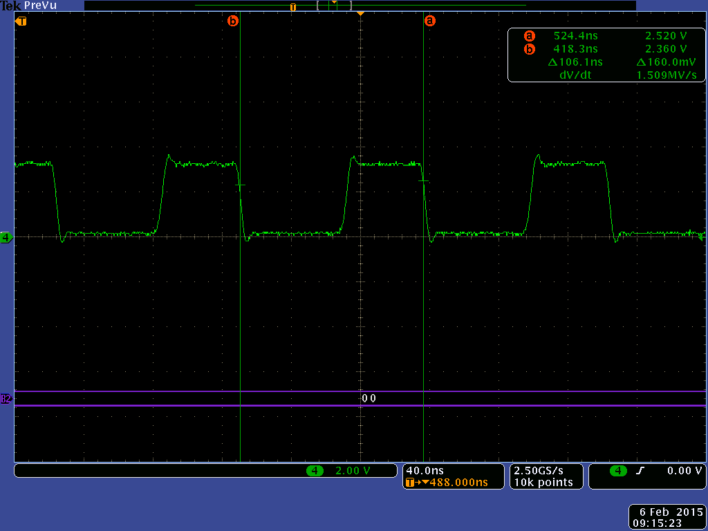

Recently i used the pin GPIO33 of F28335 to send a plus, the program copied from controlSUITE gpio_setup.c and add simple line :
while(1){
GpioDataRegs.GPBSET.bit.GPIO33=1;
GpioDataRegs.GPBCLEAR.bit.GPIO33 =1;
I configed the clock of CPU had up to 150Mhz and the plus width should be 6.67ns*2 per cycle, while through my oscilloscope it's about 100ns per cycle, has somebody meet similar problem or just give me some suggestions?

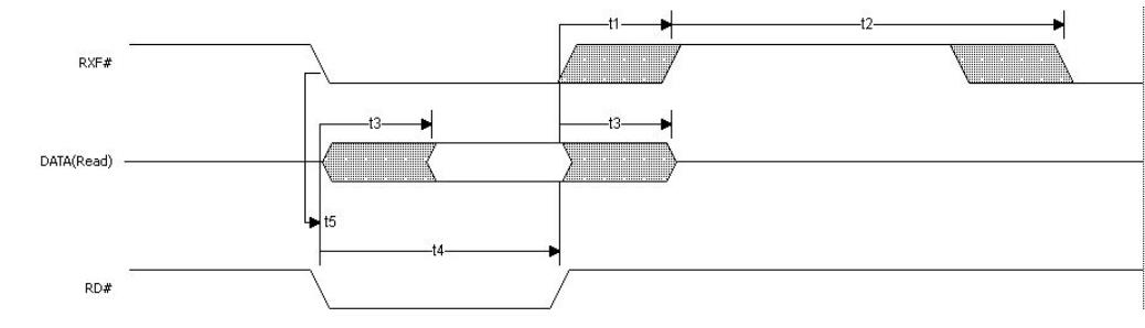

i need to reveive one byte data every time when the signal line RD# is low and then pull it up ,while the cycle of RD# line is the less the better(the largest is 160ns ), now "line high+transfer data+ line low" cost about 200ns. i had try to use epwm but it's hard to monitor , any good ideas? Thanks for your patience~
