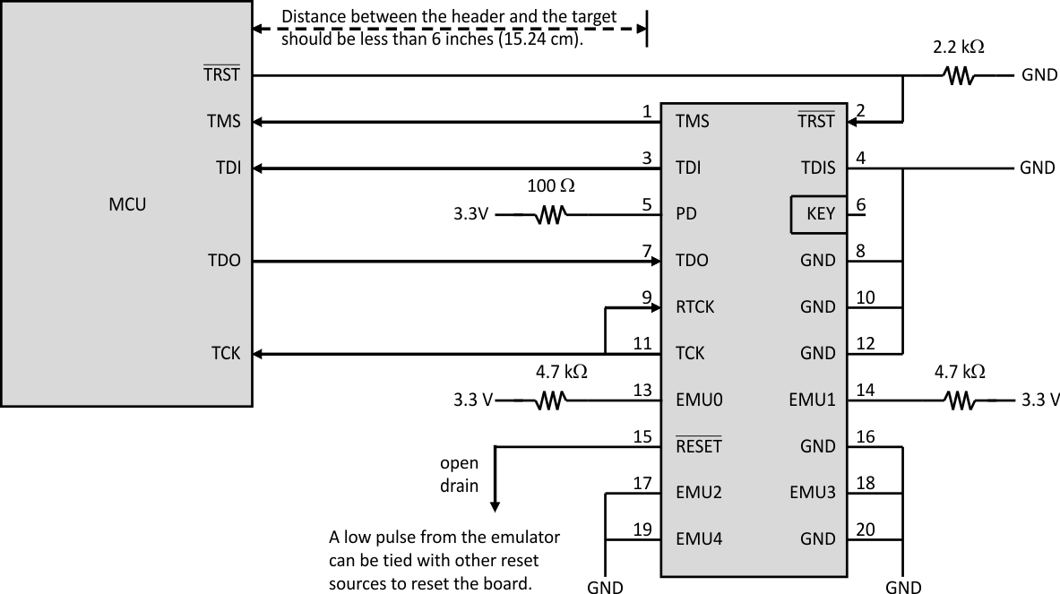

I have purchased 38 pin TMS320F28027
following are the questions
1. Previously I used to use Launcpad TMS320F28027 hence I can do similar online debugging and program uploading with it.
2. Now with standalone IC how can I do it.
3. Please suggest me the latest suitable product
If this is only for this MCU, I suggest you to use 14-pins and you can refer to the schematic that Gautam gave.
20-pins emulator will be useful if the MCU has EMU pins. F28027 doesn't have these pins.
