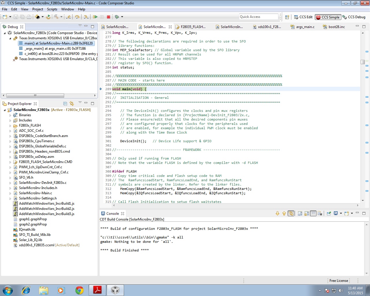

    2. What do you mean by the voltage in Vdc is not shown? Are you at incremental build level 1 and have the variables populated in the watch window??? this is when no duty cycle is driven?
  • 1.I am using GUI composer v.6
    2.DC link voltage (Vdc)  i am not getting and I am at incremental build level 3.
    I couldn't find the error.Pls give the answer
  • 1. Can you uninstall GUi Composer Runtime v6 , and install Gui Composer Runtime v5.5
    and check if you do not get any errors. (Please make sure you do un-install, as the same folder is used for subsequent GUi composer isntalls i.e. c:\ti\guicomposer
    2. Baby steps first, can you check with incremental build level 1 ? I saw a mention of DC Voltage is shown in mili amps, when ???
    Can you give me snapshot of incremental build level 1, watch window???
  • 1.) I have uninstalled GUI composer version.6 and installed version 5.5.
    2.)Watch window snap shot for your reference.
    3.)Vdc is in milli amps.
