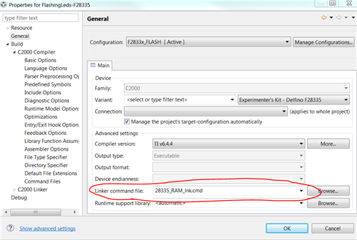

I have recently downloaded CCS Version 6 as well as ControlSuite, and am trying to set up the introductory Flashing LEDs project on the F28335 Experimenter Kit. I don't yet have access to the Experimenter Kit to try out the code, but I'm just trying to see if the files compile properly.
This is probably a really dumb question, but how much of me not having the actual board connected would this affect building the project? The reason I ask is because the only way I avoid Build Project errors is to select as my Target Device : Generic C28xx Device. If I specify anything more specific for the target like the Experimenter's Kit - Delfino 28335 or TMS320F28335, I get about 42 errors as seen below:

Again, this all makes sense if connection to the board was required for Building the project, but I have not run into such an issue when using some other platforms.
Likely not relevant since there is no target connection, but I get same above results when my Target Configuration is specified as either the Experimenter's Kit, or the actual TMS320F28335 device.
I'd appreciate any insight into this. Thanks
  • Dean,
    No connection to the board is required for building the project. The error you are seeing is because the project is including two linker command files so that's why CCS is saying the memory has already been specified.
    The project itself is included with a linker command file (circled below):
    When you go under the project properties->General and change the variant from generic to something else, another linker command file is linked to the project. This can be seen below:
    In order to fix the error, use the drop down menu from the window (above) to deselect that linker command file and select "none" so that only 1 linker command file is included in your project.
    Chris
  • Hi Chris,
    Thank you very much for your input. Deselecting the linker command to <none> did the trick, and the LED is flashing as it should!
